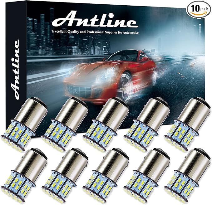

Hi all…I’m changing the LED lights on my 93 XJS 4.0. I’ve completed the flashers with no issues and included a resistor for each (pic in attached). I’m working on the stop/tail light and plan to use 1157 LED equivalent (pic attached). Having problems:
1. Each bulb is fed by 3 wires - black (ground), red (tail) and green (stop) lights
2. When I change to the LED 1567 equivalent and plug the black and red wire in the LED the tail light comes on great. When I attached the green light wire the tail light goes out ??? (I do not have the brake pedal down)
3. I took the bulb holder and tested on bench with 12V. When I attached all 3 wires on the bench both the stop and tail lights come on ???
4. I tried splicing the resistor into the black and green lines to see if that would work but when put back in car same as in 2. above - no lights. Splicing the resistor into the black and red wires still have no light.
Not sure what is going on - works on bench but not in car ?
Any thoughts or helpful ideas would be much appreciated.
thanks
JB

Are you putting the resistors in series or parallel with the LEDs? The 1157 equivalent LED should run on 12V and not need resistors to light properly. I am guessing that the resistors go in parallel to fool the bulb fail module with a load similar to an incandescent bulb.

1. I am not running any new wires. I simply replaced the incandescent bulb with the new LED 1567 equivalent but with all 3 wires attached to the bulb holder 8 get no tail light when build holder installed in car as is. If the green wire (I think this is the stop feed) is disconnected the tail light comes on. If I take the bulb holder out and test on bench with straight 12v applied to each post, both the stop and tail lights come on just fine.
2. I used the resistors for the flasher circuit to stop hyper flashing when LED installed and it works great so I thought they help with the tail/stop light issue but they dont

Answer: Mine has one bulb for each stop and tail light. Two filaments in each bulb so 1157 type

Answer: Sorry about that as I confused. I did just that and left bulb holders in the car with car wiring. I then just changed the incandescent bulb with the LED bulb and got nothing. So I disconnected the feed wires to see what was going on. When the red/slate feed was connected I got the LED tail light to come on. When I connected the green and purple feed wires the tail light went off 🤔

I owe you a huge apology for confusing you! Yes, our cars do use twin filament bulbs for the Stop / Tail light! I should have gone and checked my car rather than relying on a poor memory!
So, going back to your original problem, I'm not sure why the bulbs didn't work properly when you first inserted them? I've not heard of anyone who's replaced filament bulbs with LEDs on their XJS and they've not just worked fine.
If I was you, I would remove any resistors that you've inserted in the Stop / Tail light circuit and put the original bulbs back in. Then turn on the side lights and confirm they are working fine. Then replace the bulb on one side with an LED bulb and recheck that the side lights illuminate on both sides of the car. If the LED sidelight doesn't work, measure the voltage with the light switch on at the feed wire, (the Red / Slate wire, if you're measuring the left, or the Red / Green wire if you're measuring the right). Assuming you see 12v on that wire, if the LED isn't illuminating, I'd politely suggest you might have a bulb compatibility problem. Inserting a resistor to pull more current is just not the right answer.
As regards your indicators, there are lots of places selling suitable flasher relay units that can handle the lower current draw. A simple google search will find plenty. If you get stuck, Gil Keane in the UK at Better Car Lighting can provide one for the XJS. See here: Quicksilver Automotive You really don't want resistors increasing the current draw to get around the problem.
My apologies again for misleading you over the bulb types!
Good luck
Paul
