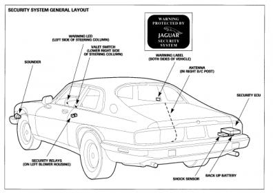

See the attached picture for where the secuirty ECU is. The security system back up battery is underneath it. Follow the procedure I already gave, not difficult. Your key fob is doing exactly what it should be doing if it's not synced ie flashes the warning LED to show communication.
The switch on the steering column is also shown. This is the valet switch for the security system.

@rjag Don't know why you can't view the picture ? anyway, I uploaded it here :
So the security system back up battery is underneath the security system control unit, which is in the trunk, on the right hand side if you are standing facing the front of the car

after studying the picture and futzing around i managed to get the security system reset and now it works. I really am amazed and i appreciate everyones help.
