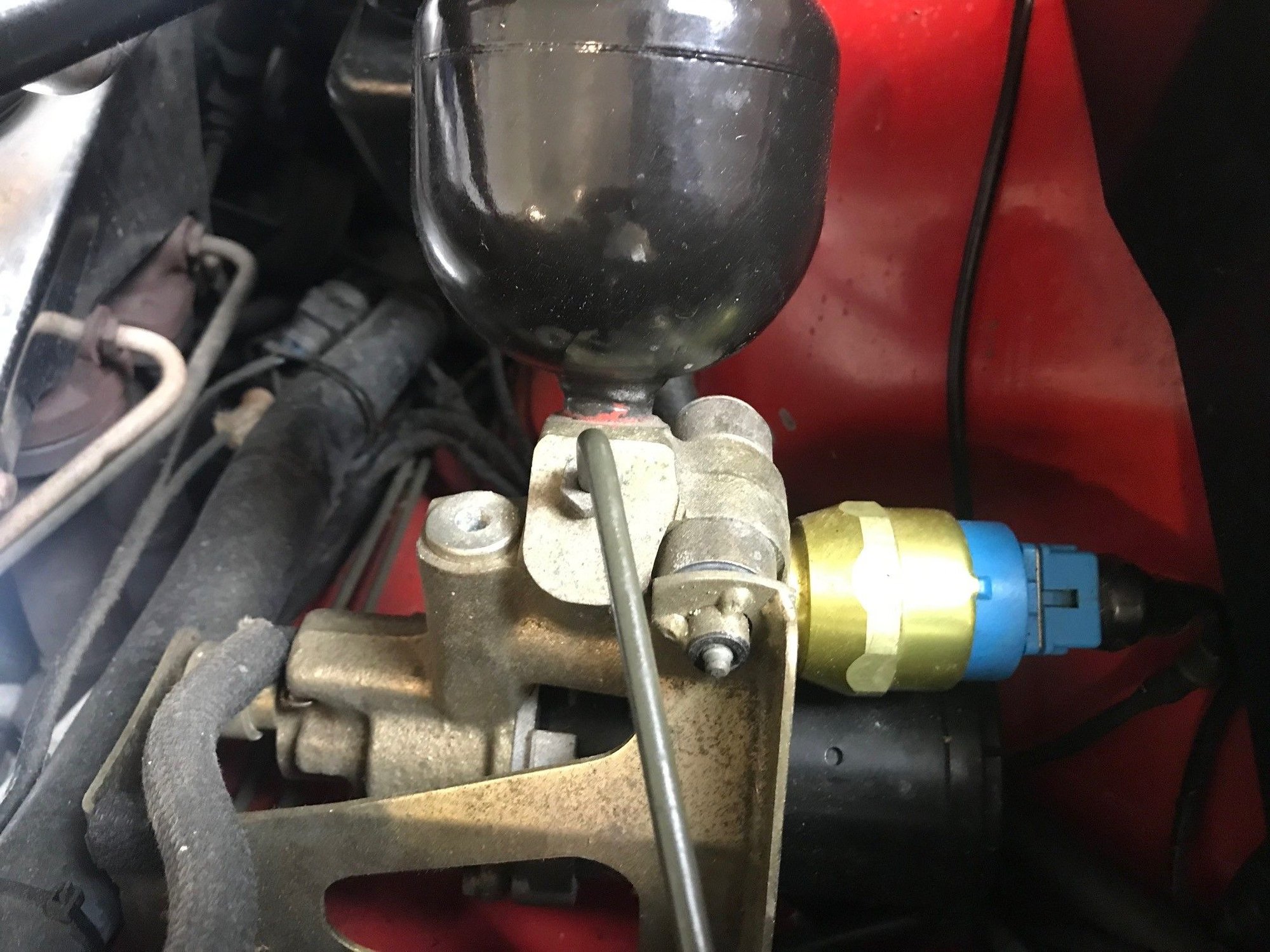

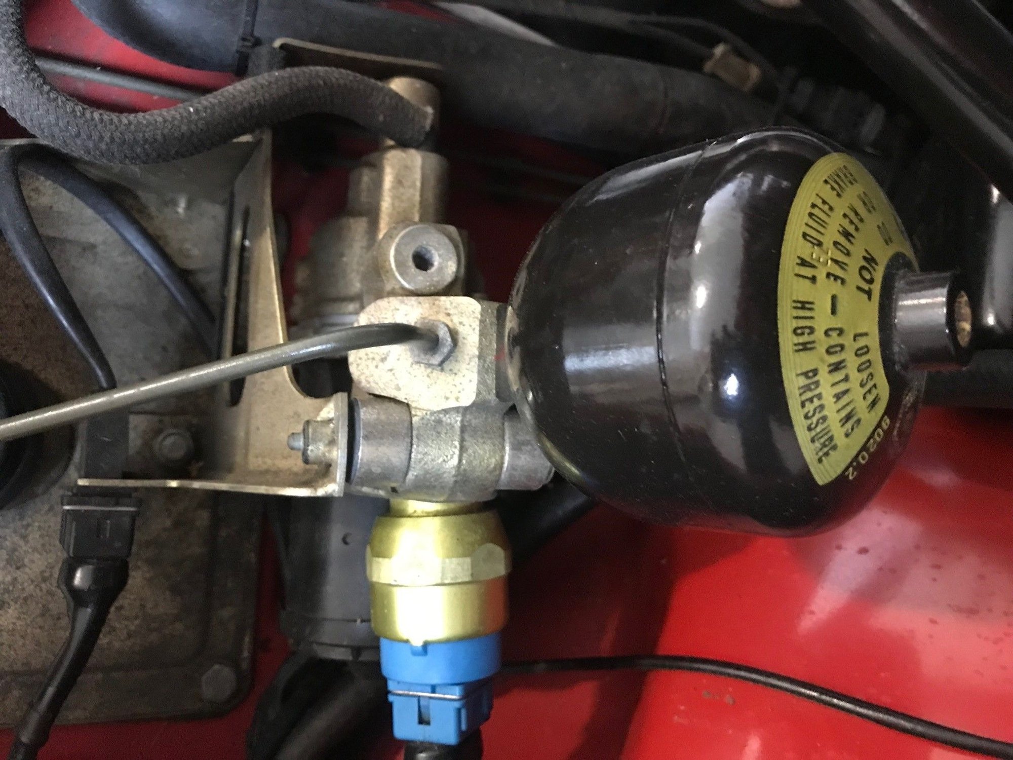

Greetings,
I could use a little bit of help in diagnosing a new issue that has come up since storing our 94' xjs over the winter.
It is has been a (mostly) wonderfully & reliable 1994 XJS 4.0 (now with only 66K original miles)-
Upon springtime starting to arrive, I began the process of going over the vehicle since being stored (indoors/climate controlled).
First off, the battery (needed to be replaced), which I did prior to starting the vehicle for the first time this year.
Everything came to life as it should, motor started right up and sounds great, no other noticeable issue than the ABS warning lamp question I have for you here.
Upon starting the car, all warning lamps cycle through as normal, however the amber Red BRAKE light stayed on several seconds longer than normal and the Amber ABS lamp does not turn off...
I tried the pumping of the brakes 25+ times with the ignition off as referenced in several other Threads, and no change -
Upon restarting the car, the Red BRAKE lamp stays on a bit longer (aprox 10-12 seconds), where it used to be about 2-3 seconds.
The Amber ABS indicator stays lit constantly.
There are no fluid leaks visible anywhere, fluid reservoir is at proper level, brake pedal has good resistance (pressure) with no difference noted from last year.
Just a bit of rolling up and down the driveway and there is no noticeable difference in braking other than the ABS light stays illuminated.
Reluctant to drive it much more than that, but may venture out to the quieter side streets & see if I notice a difference as 30mph down to 0mph.
Found this prior thread, not sure I have the same issue- but at least something on a similar year XJS to start from:
https://www.jaguarforums.com/forum/x...94-xjs-179016/
Would really appreciate any thoughts on the matter as it is approaching the time of year where we really enjoy getting out on the highway with it!
Thanks in advance!
Amber ANTI-LOCK warning lamp will not go out
Open Bonnet from L.H. side
Top front of reservoir and connections
Right side of reservoir and abs module
Another right side view of abs mod.
close up of abs mod.
Accumulator pump view looking forward
Accumulator pump view looking down from above
Springtime! Hopefully motoring safely soon...
Pictures Attached

C. Nystrom,
If the accumulator is not holding pressure, you will notice it in 2 ways:
- the abs pump will take longer to run when you first start the car in the morning
- the abs pump will be cutting in more frequently when you're driving the car and using the brakes.
If you've had the light stuck on, it seems that it would have thrown fault codes. So performing the abs blink test will identify which code has been generated. I'd strongly suggest your run the test even if the problem seems to have gone for now.
Good luck

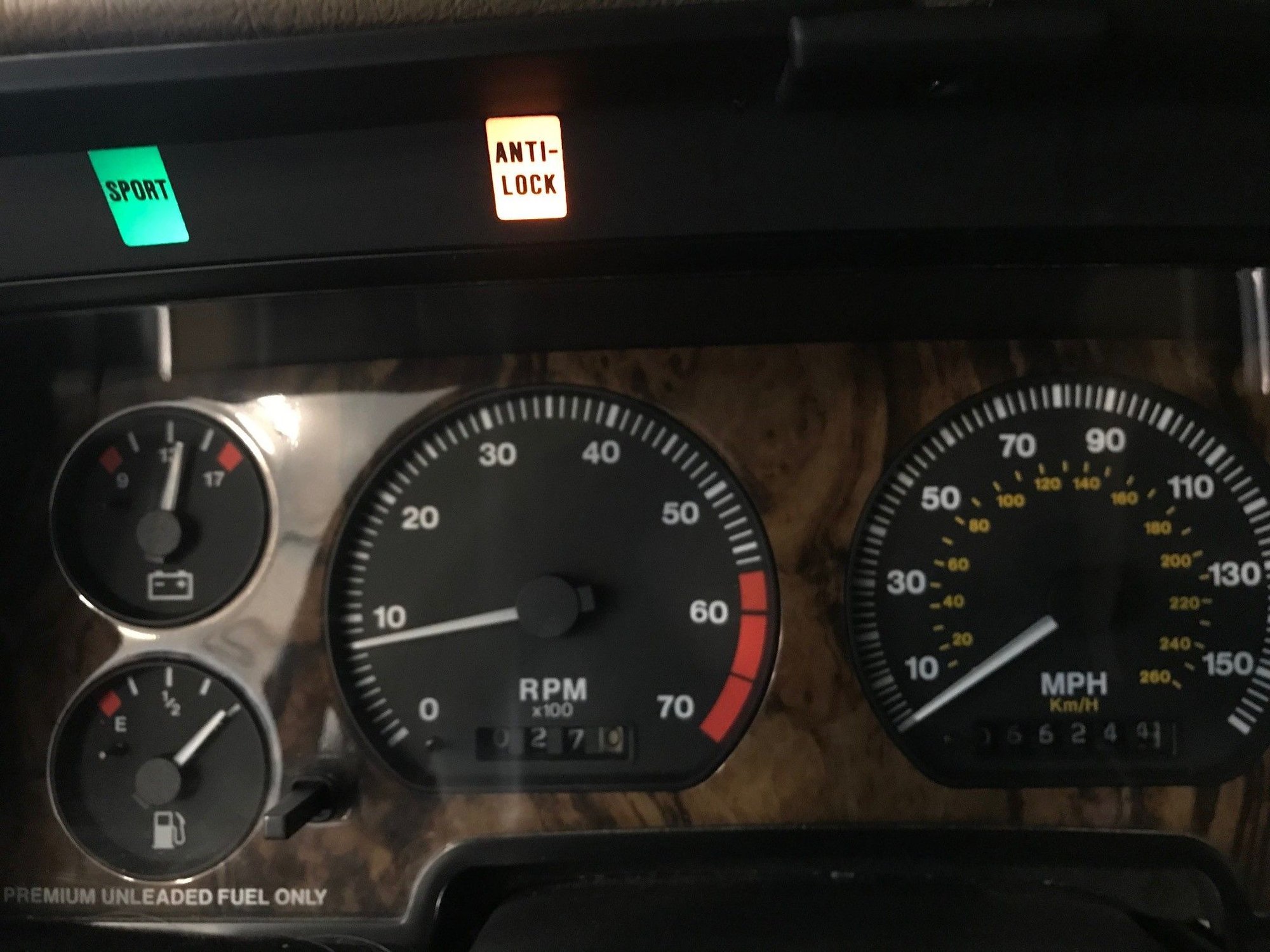

I am uploading some fresh pictures of what is shown on the dash since the problem seems to have resolved itself for the moment.
Also, if you have any recommendations as to how to get the trip computer to give any diagnostic info, it would be much appreciated.
"Check Engine" briefly appears, as it always has & the goes away almost instantly.
Not seeing where I can get it to display anything other than the fuel & mileage & clodk data.
Chuck
1) Ignition Off -
2) Ignition ON- "Check Engine" shows above the time very briefly & goes away.
3) Ignition ON - starter not engaged.
4) Ignition ON - Car Started - briefly displays these brake system indicators.
5) Ignition ON- car running at idle - Sequentially Park Brake indicator goes out first, Brake 2nd and Anti-Lock 3rd, and all are staying off as of this update.
