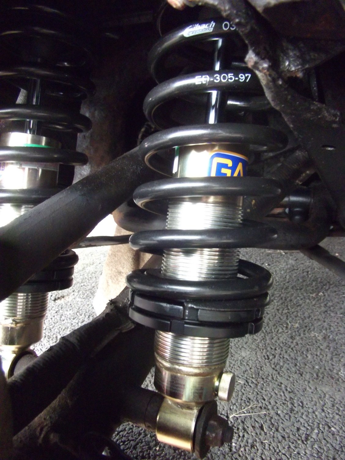

I use Gaz shocks with Eibach springs (they were derived from the Aston DB7 that uses the same rear end setup).
I initially fitted the Gaz shocks which have adjustable damping (a simple turn button adjustment that can be done in seconds without any tools. However, although I easily could get the ride to suit my preferences (slightly firm), I couldn't get the ride height perfect. Gaz then brought out an adjustable height model also with the variable damping. The adjustable spring height is achieved using a collar on the body of the shock which (using a large C-type wrench) enables the ride height to be set exactly where you want,
So I swapped out my original shocks and fitted the adjustable height ones. Once I'd set the height and damping to suit road use, I just adjust the damping for track days etc. I'm really happy with the purchase and can definitely recommend them.

AVO make adjustable platform shocks for the XJS. I have them and they are fine, no real differences from the GAZes I find.
