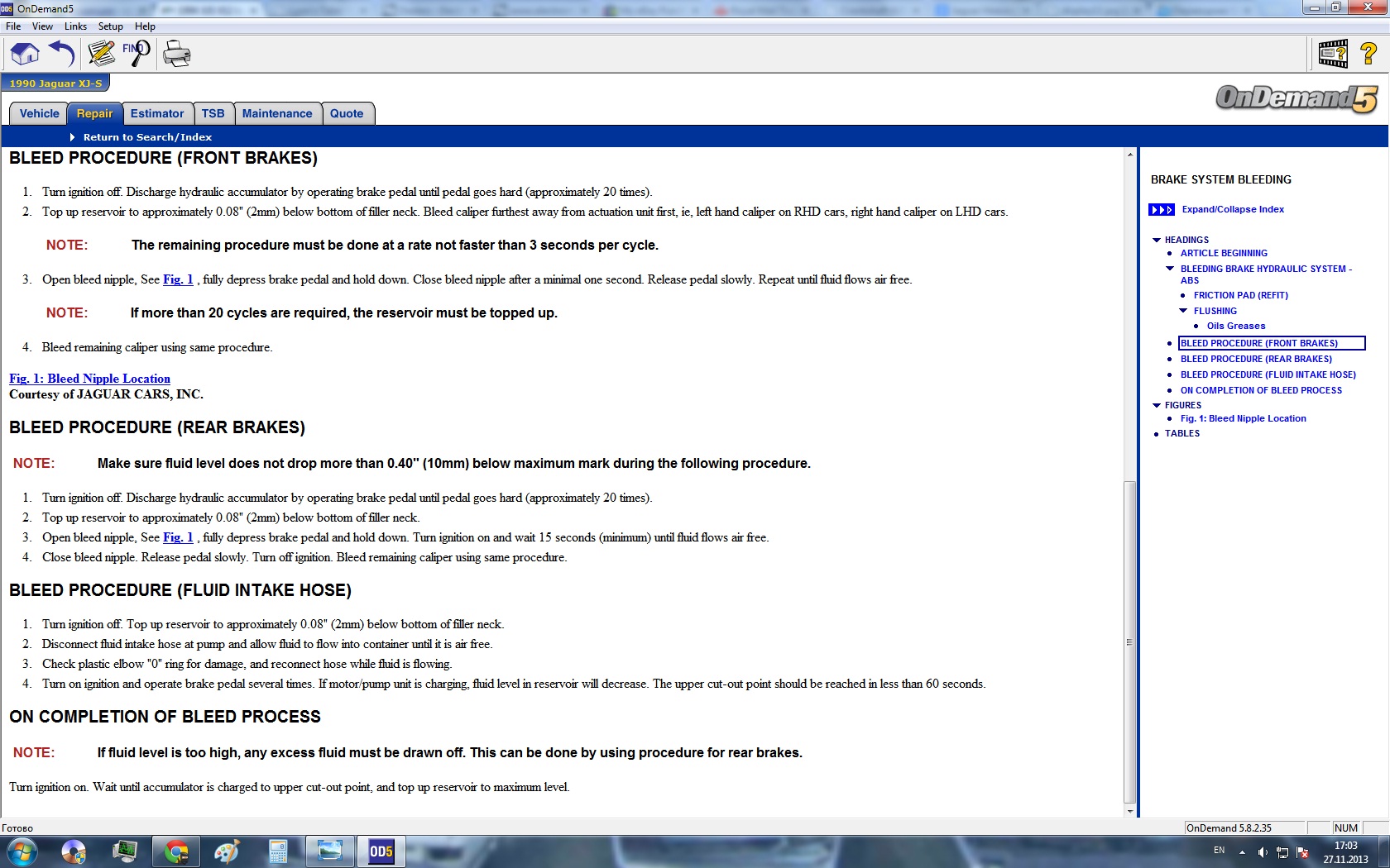

Old Nov 27, 2013 | 07:07 AM
xjsv12's Avatar
Joined: Nov 2012
Posts: 1,085
Likes: 356
From: Moscow Russia
Bleeding
Old Nov 27, 2013 | 07:09 AM
xjsv12's Avatar
Joined: Nov 2012
Posts: 1,085
Likes: 356
From: Moscow Russia
bleeding

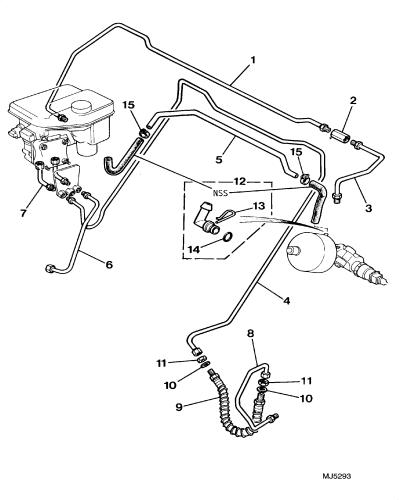

Oh b*ll*x, I managed to break the little plastic elbow on the rubber hose that goes to the ABS pump. Anyone know the part #. I can't seem to find it anywhere.
Thanks
Old Nov 29, 2013 | 09:05 AM
xjsv12's Avatar
Joined: Nov 2012
Posts: 1,085
Likes: 356
From: Moscow Russia
12 + Hose kit
+ To VIN (198334)
+ high pressure
JLM1462 £56.43 Add to cart
+ low pressure
+ LHD
JLM1471 Contact Us
+ RHD
JLM1470 £19.99 Add to cart
