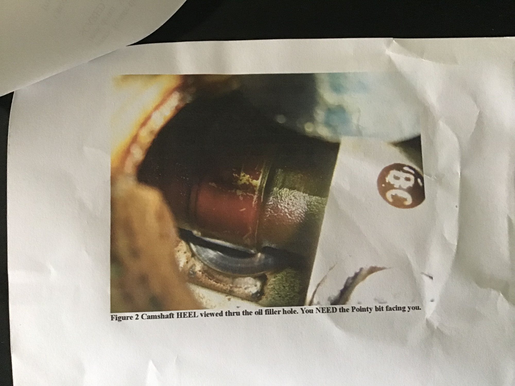

Since I was just doing a replacement, I took the liberty of getting the dot close to top dead center ( in plastic window) before removing by cranking engine over. I then removed and put the replacement sensor in and with the dot at the same position. Easy and fast. I took before and after pics verifying the position of the dot in the window.
But I will use the procedure to verify TDC and and check my fitting at a later date.. Again thank you
