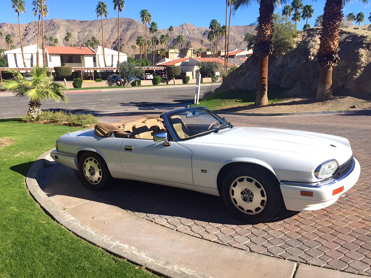

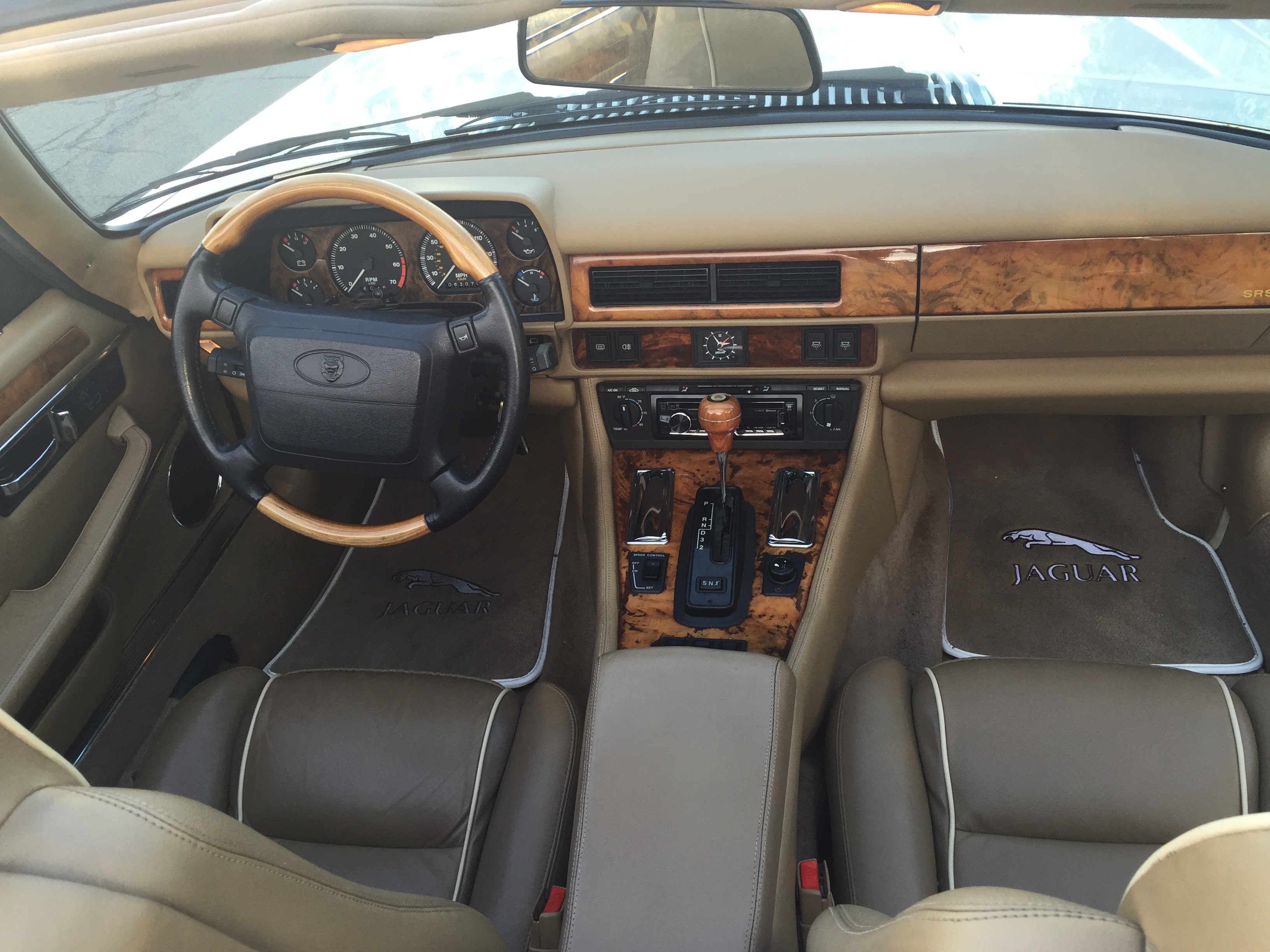

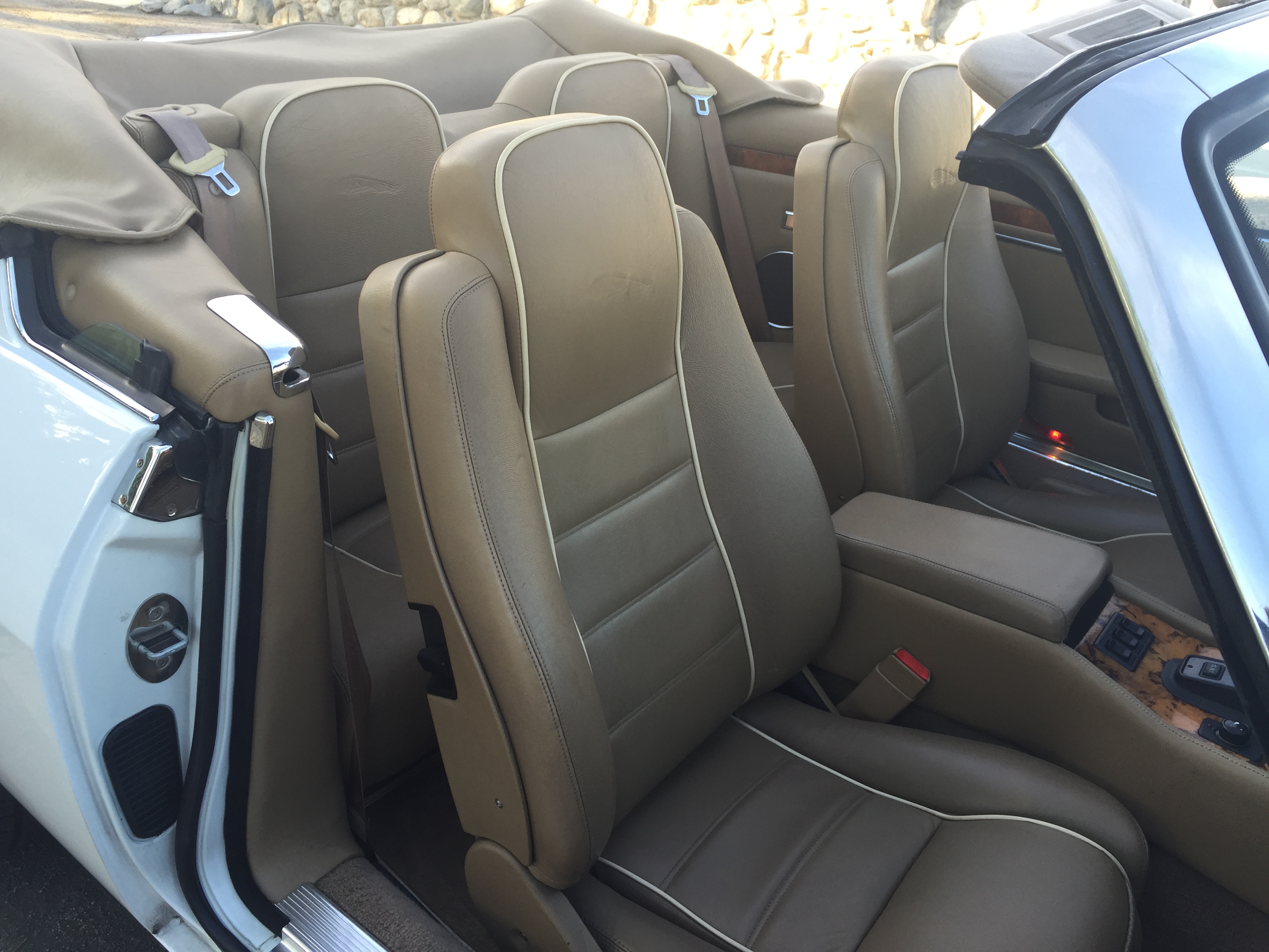

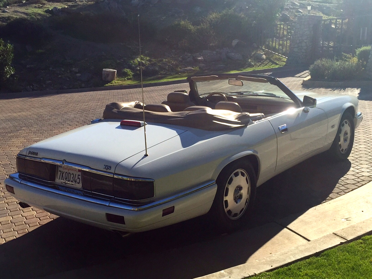

Default 1996 Jaguar xjs convertible issue, help!!!
I have an all original 1996 that is in stellar condition... 9 out of 10 for sure.
All of a sudden the car began to stall and conk out when it got too hot, granted it is 188 degrees out as well and after a bit it would be fine for a bit.
I brought her into a station and had a new thermostat put in and the mechanic said he could not use the diagnostic equipment he had as it wont work on the car so we need to wait till it does it long enough or it does. 48 days later I picked it up and brought her to another shop, a Mobil... same exact thing, they could not locate it. Then I had her towed to a Jag dealer and they said, LISTEN AT THIS POINT IT'S NOT A FIX, ITS A RESTORATION"... sell it and be done or we have to throw stuff in that it might not be as its a total guessing game.
So now she is on my driveway and I am about to ship her to NY as I am moving from CA.
My idea was maybe since she is so clean I should put a chevy engine in her and begin a new? I dont care whats inside to be honest.
Anybody have any input to what it can be?? I fuel pump? they all doubt it.
Gets hot and stalls...
I was about to sell her for $14k when this occurred and decided to wait to fix her...

Made me laugh to hear that the dealer said " at this point it is a restoration ". From the look of your photos this XJS is far from being a restoration. You would think that the Jaguar dealer is the expert on a 1996 XJS but the truth is they probably do not have any techs left that are even familiar with the mid 90's Jags be it a 4.0L or V12. The '96 XJS has the same engine as the '95 to '97 XJ6 so you would think that the dealer would still be familiar with this set up but often they are focused on the V8 now.

Can I take it for granted that you are aware that your XJS is the highly desirable Celebration Convertible that any collector would lust after.
So don't give up on Her just yet.
