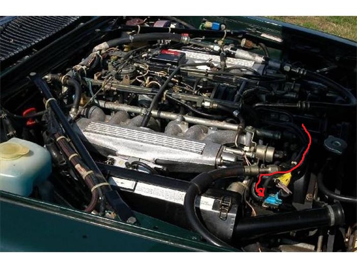

it connects to the pipe running on top of the radiator.

how are you not spewing water everywhere you go lol

Whoops!!! 11:40 was apparently past my bedtime yesterday!!

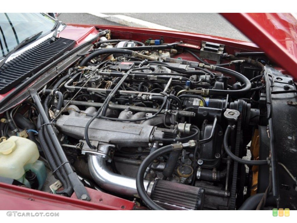

I checked around here and couldn't find anything today but I suppose it could be for the bellows and routed differently than usual.
Here is where you normally see that line

The cruise control "bellows" is the rubber accordian-ish thing with a cable attached, just aft of the a/c compressor. When vacuum is applied the bellows draws inward to hold the throttle.
The blue thingy shown in one of the pics is some sort of release valve as I recall. On older XJSs I *think* they were installed as part of a recall...and then became standard issue on later cars such as yours. My '88 had one.
