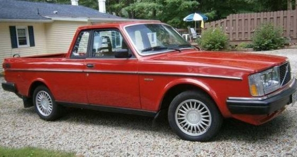

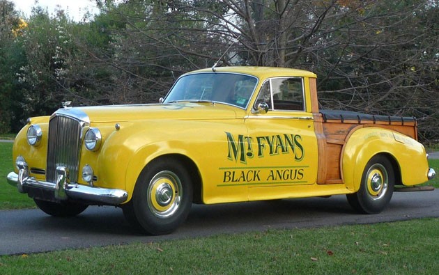

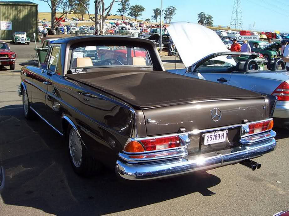

350 Chevy engines to replace V12-1.jpg350 Chevy engines to replace V12-2.jpg350 Chevy engines to replace V12-3.jpg350 Chevy engines to replace V12-4.jpg

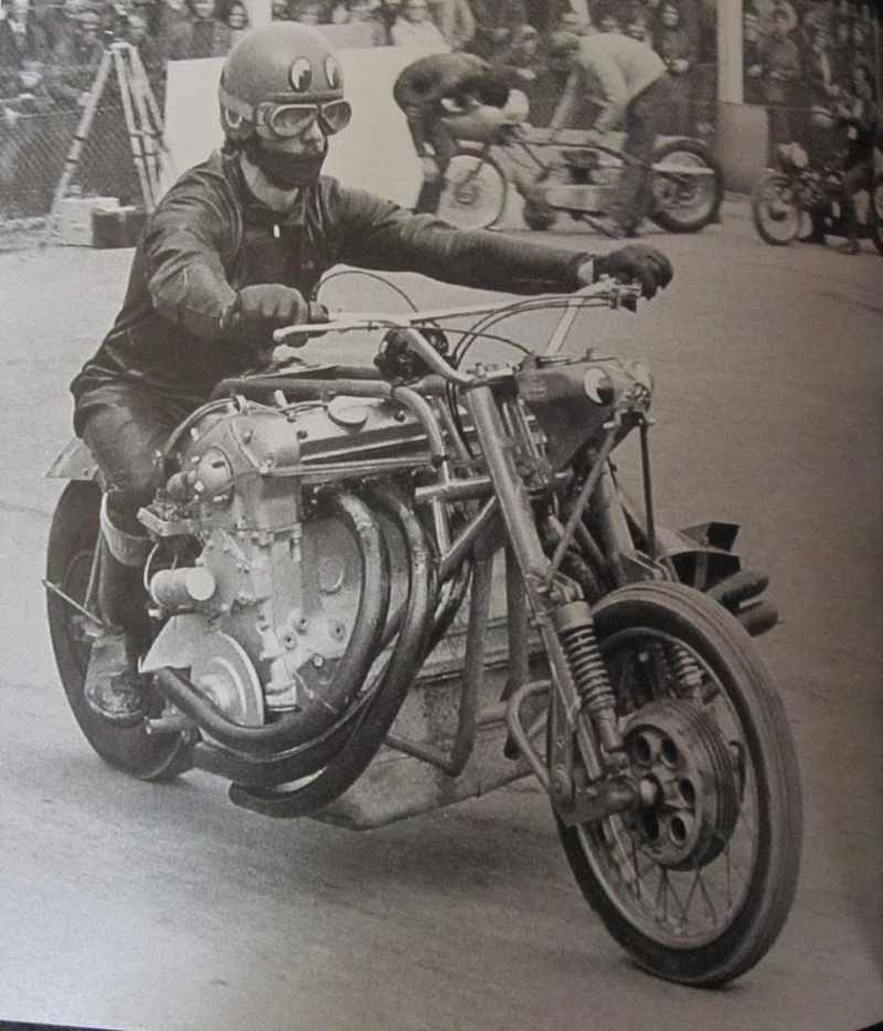

Of course all those discarded XK engines could be put in bikes(wonder if a V12 would fit?
