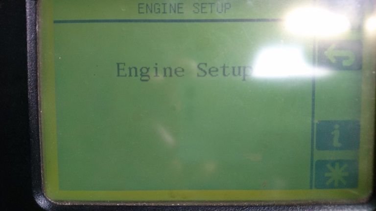

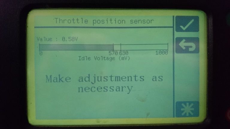

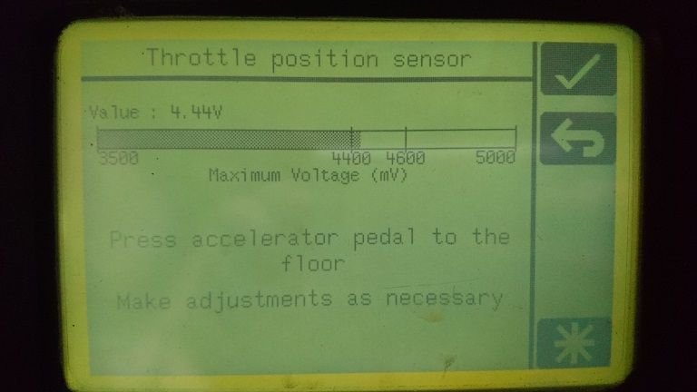

Although this topic is about a AJ16 engine, I had to share the TPS setup procedure on a AJ6 engine. Maybe it is helpful for somebody.
All you have to do is find a signal wire on the TPS or ECU to measure the voltage the TPS is sending to the ECU.
After the throttle setup, you can start the car to operating temperature and than adjust the RPM between 650 and 750.
Keep us updated Steve how you are doing with your car and your fix.
