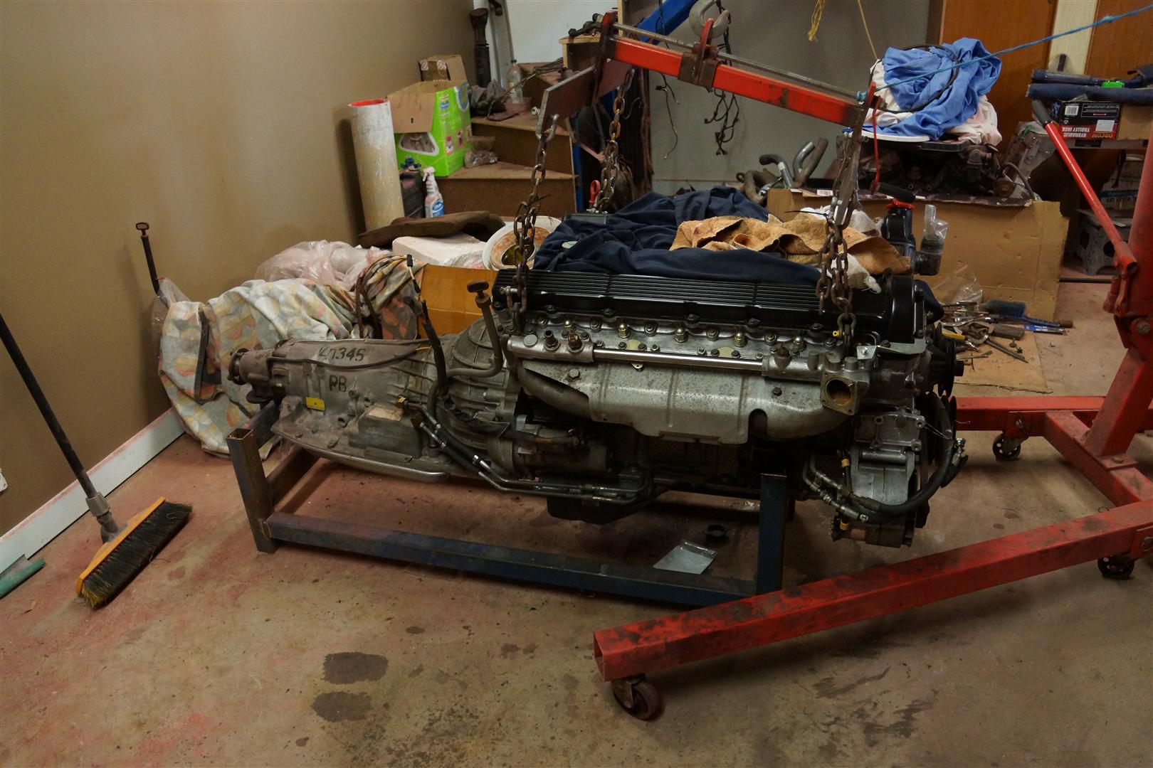

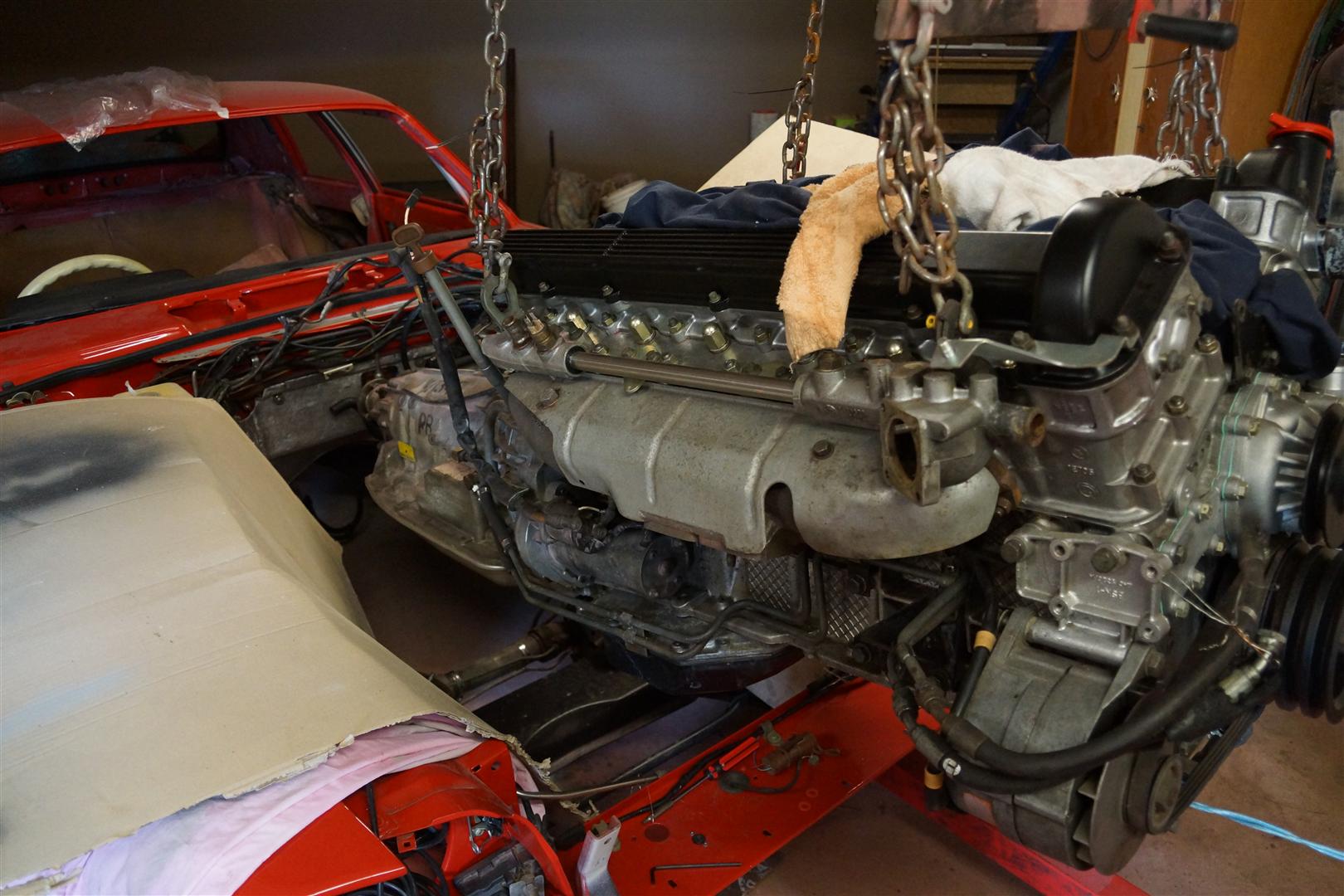

6 litre and 4L80e finally fitted to my '89. Went off without a hitch in three hours with just myself on the job.
With the mods i made to the gearbox it is a perfect fit with ample clearance with no body mods to the trans tunnel and original 6 litre rear mount is a direct bolt up to existing mount holes.
Control is via EZ TCU fitted in left hand footwell.
Even the original trans shift set up works fine with only change an earlier shift cable a little shorter overall
Attached Thumbnails 4L80E swap in '89-dsc09272-large-.jpg   4L80E swap in '89-dsc09294-large-.jpg   4L80E swap in '89-dsc09302-large-.jpg   4L80E swap in '89-dsc09316-large-.jpg

Engine oil cooler will be unchanged as my '89 had full flow system anyway. I crimped olives onto the trans cooler lines prior to fitting rubber hose to prevent any chance of them simply slipping off the pipes.
One thing I did find with the swap related to clearance is the need to lay back the flange where the firewall joins the trans tunnel just where the dip stick/filler tube runs. I did that with the trans in the car but it would be much easier if you did it before.
