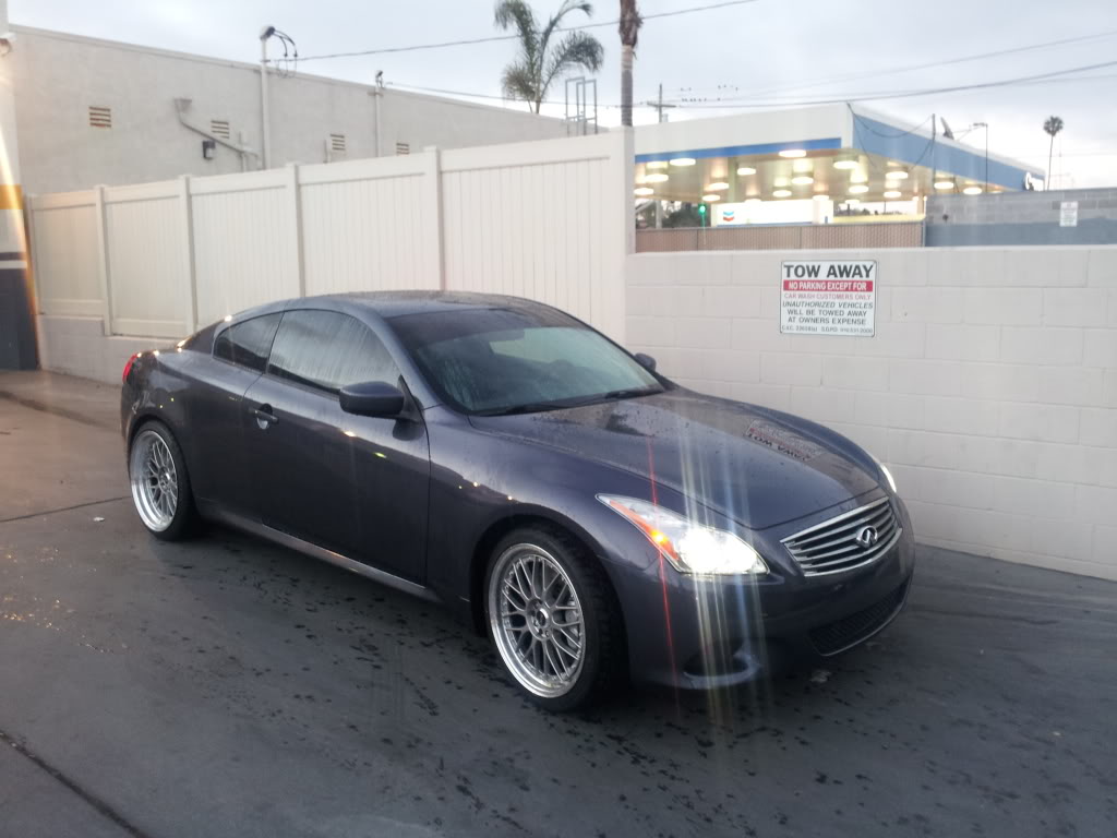

I found your post intriguing as I am a Z enthusiast and a Jag lover. This is my daily driver right now. It is the great great great grandbaby of the 240z.
