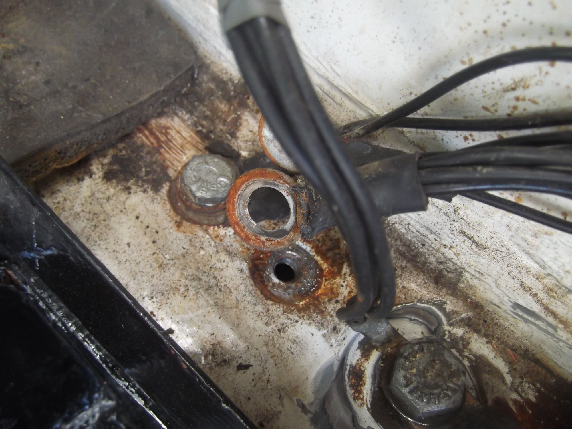

Further to Doug's points, there are two huge earth clusters just to the right of the battery in the boot. Pull the side trim and the carpet and you will see it on top of the chassis rail by the battery tray RHS. This is often very corroded.

Hey Greg. Thanks. I think you are onto something.
I put a jumper lead from the -ve battery terminal to another part of the chassis and it appears to now be working well.
Tomorrow, I'll locate and clean those terminals.
Thank you.

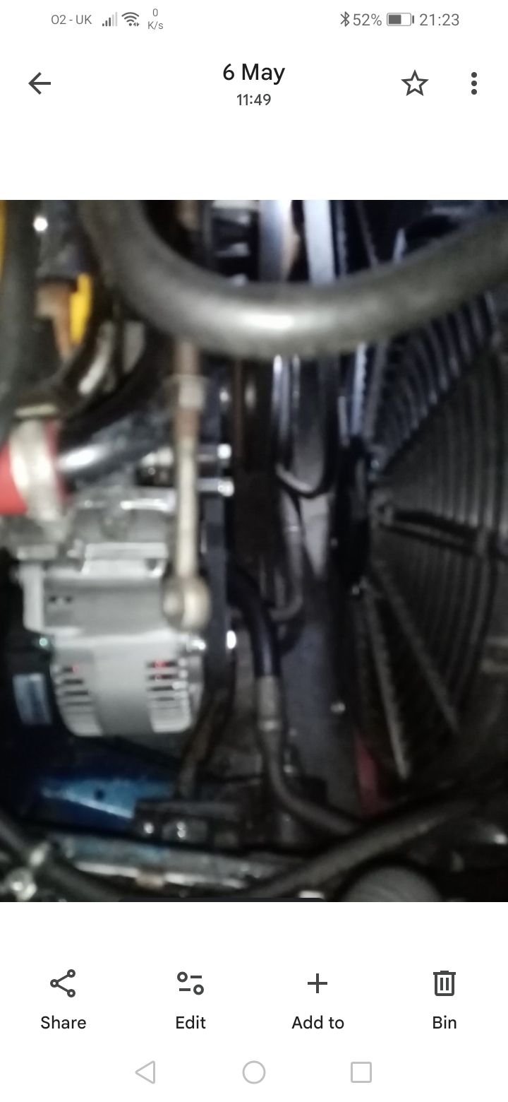

I got through 4 second hand bosch 115amp alternator in a very short time so having seen reputable specialist suppliers offering 120amp brand new with warranty that are all perfect fit for the Lucas/bosch bracketry for just over a ton I purchased one and it's been perfect.

manchester auto electrics via ebay range rover 120amp

I checked all the earth connections in the boot. All good. No corrosion.
