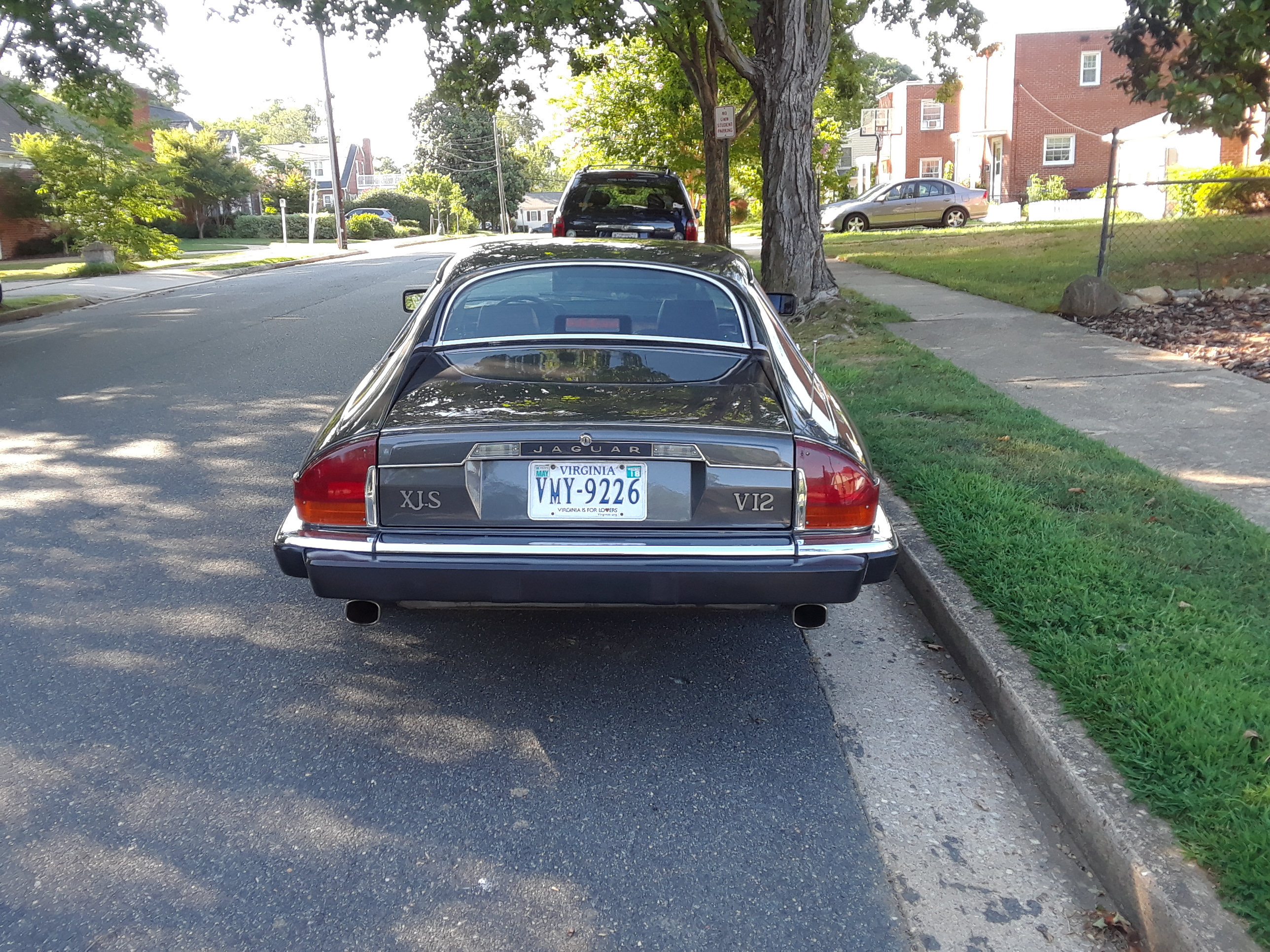

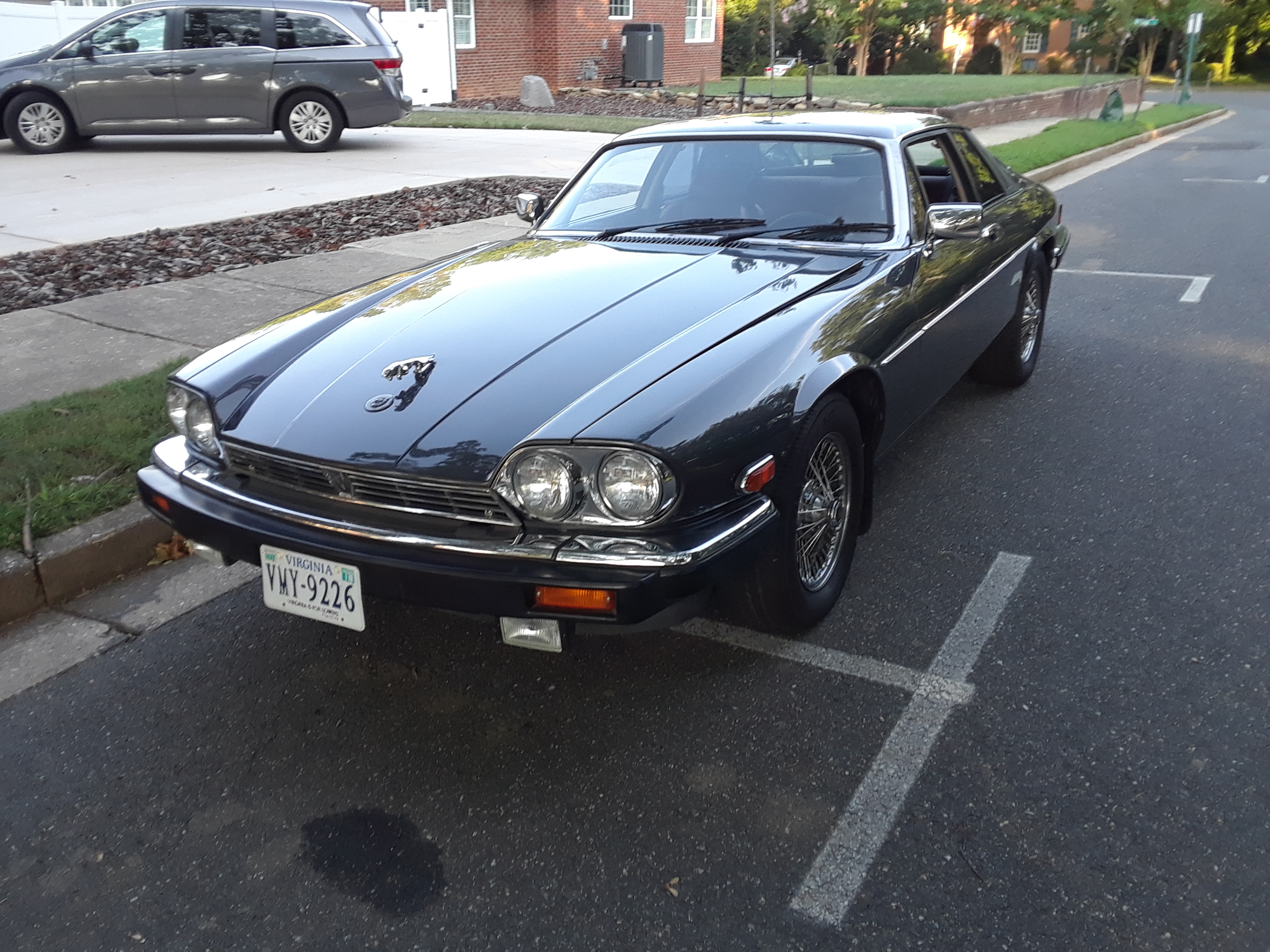

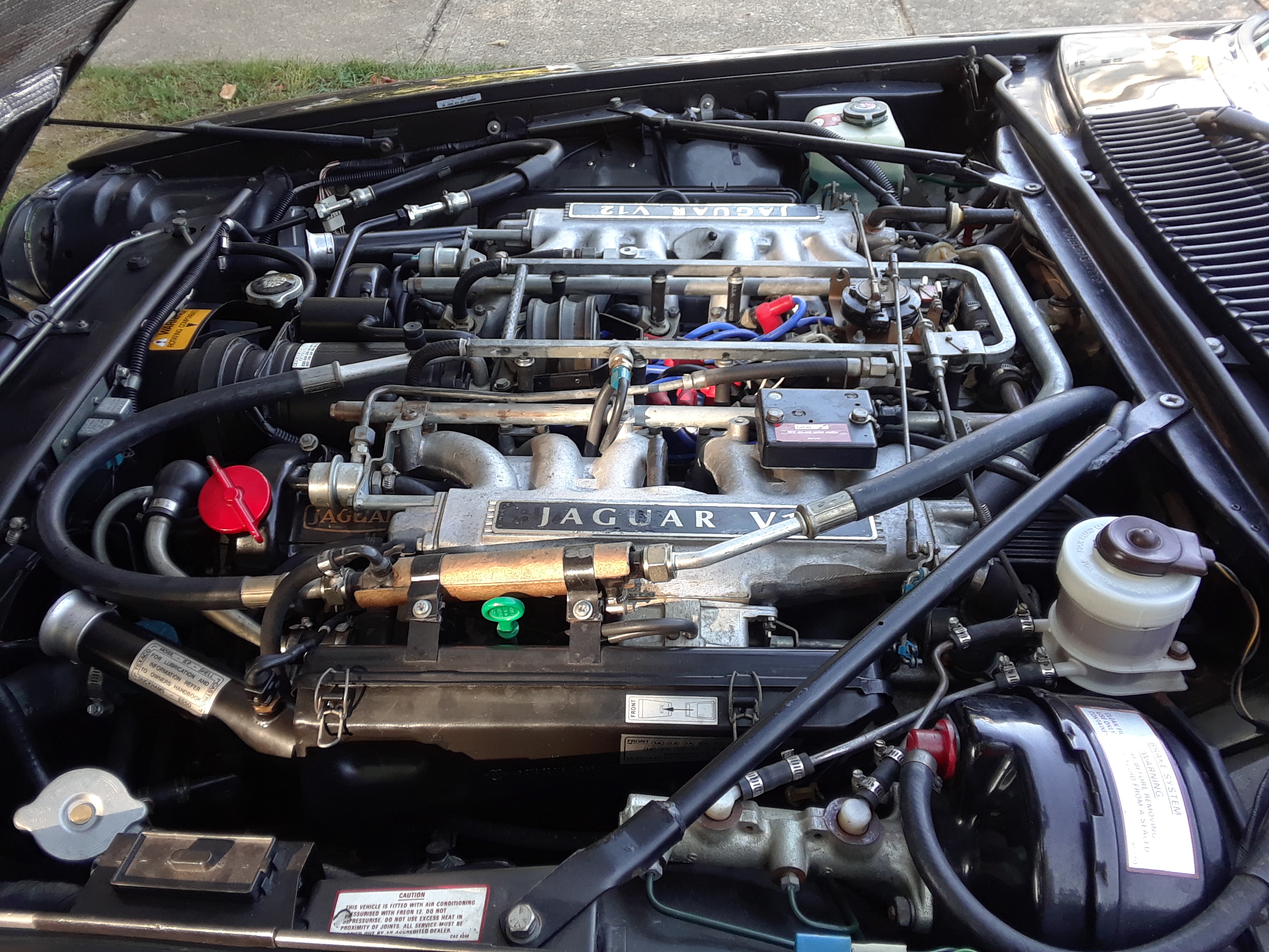

Not sure if the photos uploaded.
Thanks, I've always thought it was a pretty color combo. You don't see it very often.
Too few cars have interesting color combo's these days.
