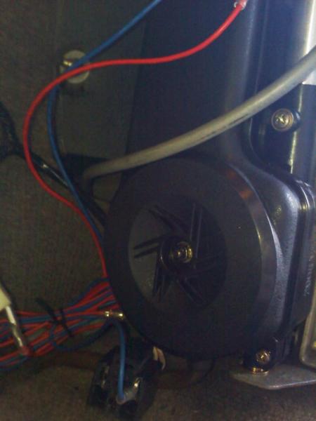

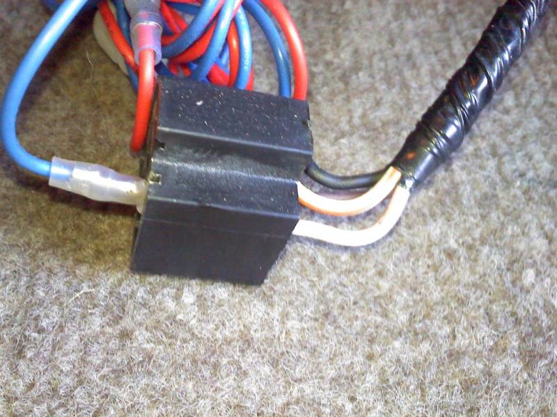

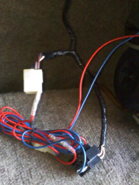

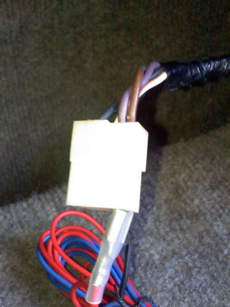

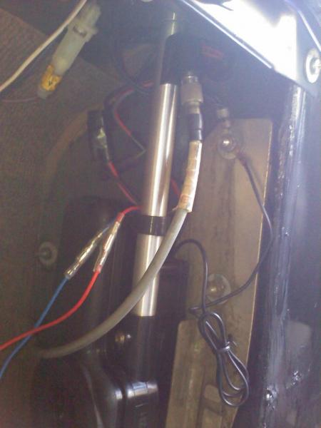

Hope these load...the Metra Euro has three wires, Blue, Red, Black...Blk is Ground and mounts to mount plate...red and blue are shown where to plug into factory harness.....spot tie and tuck next to unit and put the carpeted cover back on.
