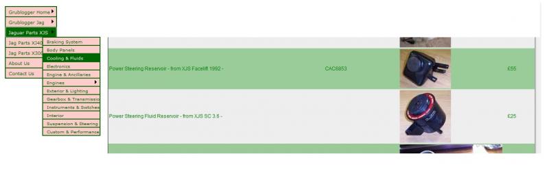

An internet search suggests these things are scarce in the UK.
If it's one of these types you're after ...............
............ Grublogger | Used Jaguar Parts | Used Jaguar Spares | Jaguar Breakers | XJ-S | XJR-S | XJS are listing both (17th Dec 2012)
Attached Thumbnails Dammit -was going so well!-xjs-power-steering-reservoir.jpg

Thanks. Am a little put out with Grublogger - as the tank is on his site for £55, yet via email he wants £70 plus postage. Manged to source one in Bolton for £40 delivered.
