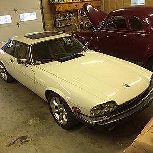

Hello again, got the brakes working but now it shut off and will not start again. It has no spark but power at coils and injectors. This happened while idling last fall so i just put it away for the winter (I don't my classics in the Boston winters; road salt!!!!). Any way pulled it out in the spring, still no spark. removed the cap and rotor all looked good. Ohmed the cap and rotor good, tested for power at coils, good. went to test for injector pulse and the car fired right up? Been running all summer but i have not driven it due to brake issues. Thank for the help there. Drove the car locally this weekend, no problem. Pulled it out of the garage this morning to work on some other minor issues and once again it shut off while idling? Once again, no spark, no injector pulse but power to the coils and injectors. My gut tells me crank sensor(s) but i have little experience with the Marelli system and shop manuals I ordered for my 89 are for the earlier ignition system and of little use. Thoughts and sugestions would be appreciated. Mark.

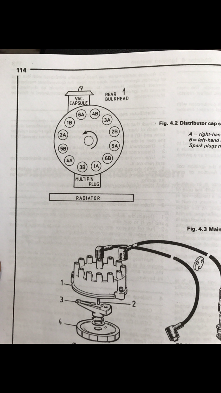

Does this help.

Originally Posted by acauto
Does this help.
yeah ive also followed that diagram the jaguar manual says do it this way....
But this way it dosent rev past 2000 rpm
Old Sep 8, 2017 | 09:40 AM
acauto's Avatar
Joined: Jun 2017
Posts: 28
From: Wakefield, MA. 01880
The diagram you are posting is not for the Marelli system. That is the earlier system. Make sure the upper coil is going to the "B" coil post on the dist cap.

Exactly. Twoi different ignition systems. They are both TOTALLY different. Kind of like V6 and I6 engines

Thanks for your replies.. the car shop gave me this book whoch goes up to 1988 and mine is 1999.. they said it would be same order but guess not as u mentioned.. will look in to getting the actual manual.. any idea where to buy from?? Thanks
