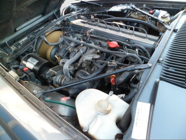

Ohh.. I have a yellow fan in mine...
Guess another thing on the "to replace" list.
Q: Turning the key to start the key, first position, the small fan seems to start, then when the engine runs, the main fan starts.. Is this fan not thermo controlled to start when Temp gets to a certain point?

Yes, might be a good idea. Take a hard look at the blades and you'll almost certainly see age cracks.
The danger is double if the fan clutch seizes up, allowing the elderly fan to spin at full engine RPM
Pre-89 models (I'm talking V12s but probably the same on the 6 cylinder cars) were designed so that the the e-fan operates:
A)whenever the coolant reaches X-temperature (94ºC as I recall, via a temp switch)
OR
B)whenever the a/c compressor was engaged (via voltage from the compressor clutch circuit). And, since the a/c compressor is engaged in all climate control modes, that means the e-fan comes on all the time!
Turn your climate control "off" and try again.
Later cars had several different e-fan wiring/operational schemes.
