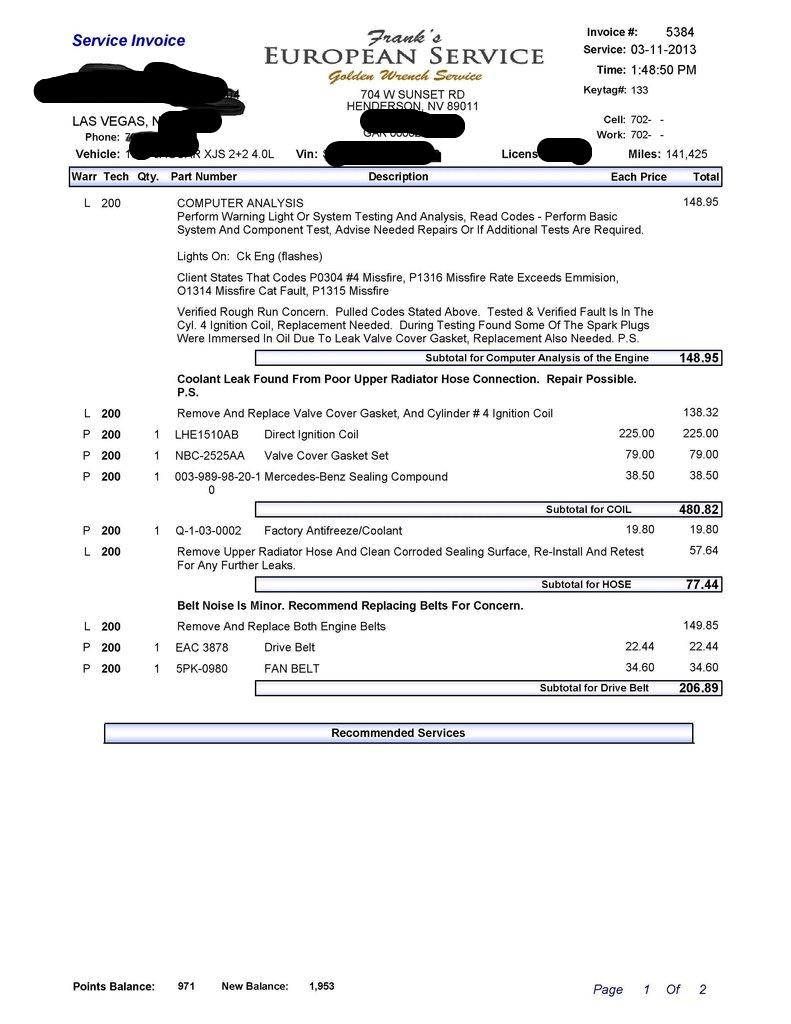

Here is the invoice

Here is the invoice
Please don't say you almost paid 1 thousand dollars for a 100 ignition coil, a 60 dollar cam cover gasket and one hour of labor....
I did not have the first page of the invoice uploaded.
Other stuff is being done to the car as well, Lower Radiator hose, and new belts. Totals out to $1000 basically.

$480 to replace one coil and the gasket.
The coil is probably twice what you would have paid, but the gasket set is about right and the hours charged, I suppose, follows "the book" even though all of the coils needed to be removed to replace the gasket, so whatever time he charged against changing the coil is a double charge. It really should have been $225 + $79 + ($15 for shop supplies, he will not use an entire tube of this "Mercedes Benz sealing compound") + one hour of his time.
He really should have recommended that the plugs be changed as well.
I suppose the warranty has got to be worth something as well...
