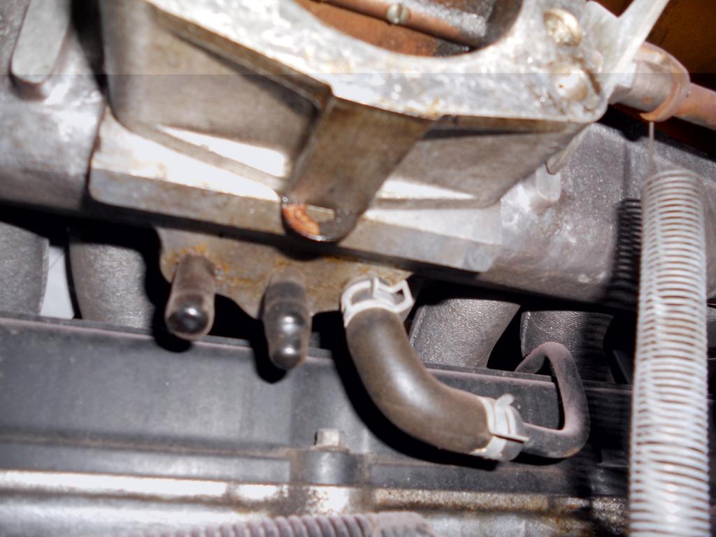

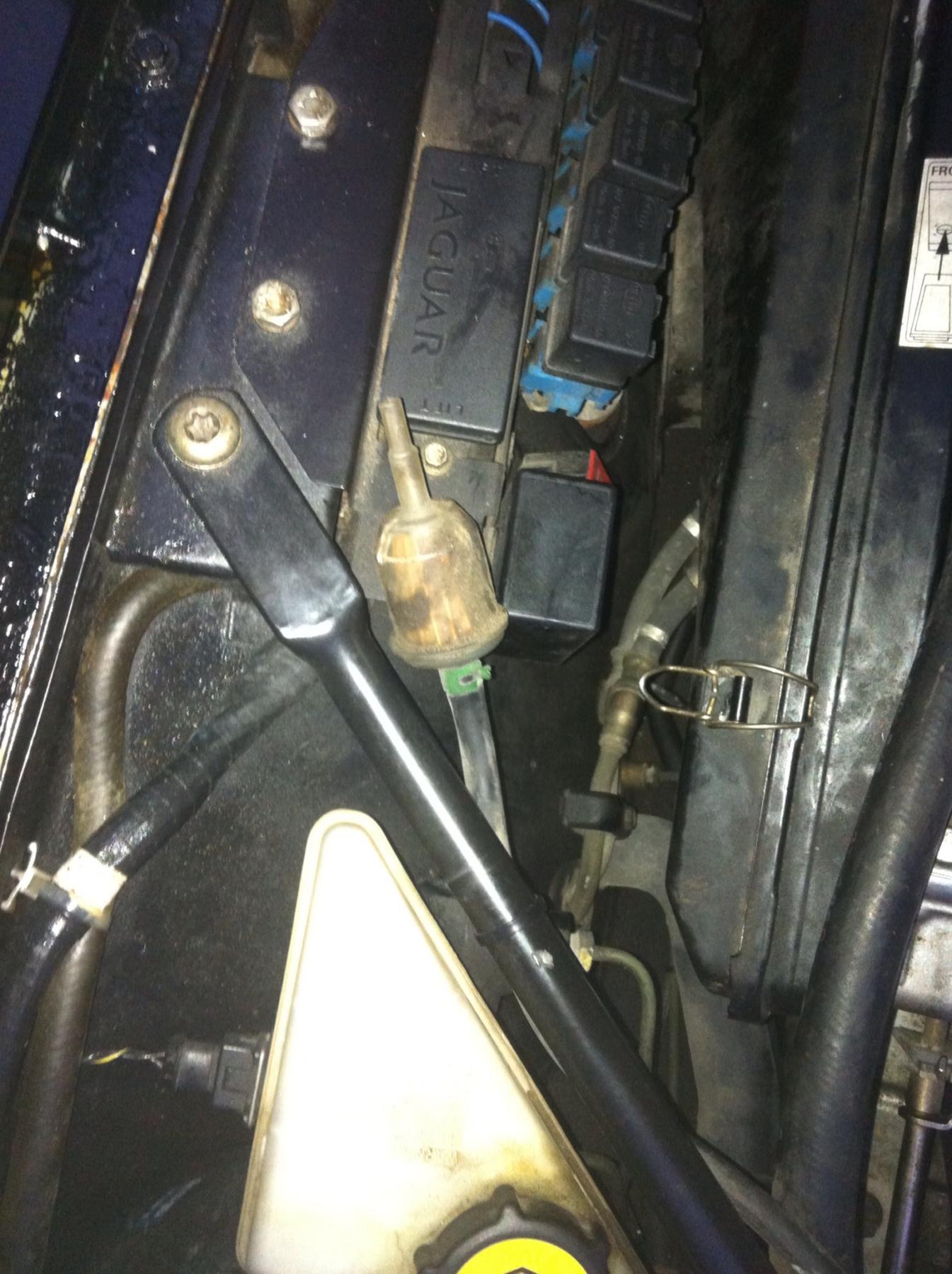

Well, last week I took a drive with my new steering wheel on and the top down, and went over to visit family.....when I came back out, the car was idling extremely quickly and i noticed that when I applied the brakes and then let the brakes go, the car would move quickly ahead. That was traced down to a faulty AAV valve that all of a sudden gave up on me.....after replacing it, and one throttle bushing, I heard a very loud "hissing" sound coming from the driver side area of the engine in the area of the new AAV....after much frustration, I found the source, which is an open vacuum port under the intake manifold, right under where the "r" is on the Jaguar decal on the same manifold (6 litre XJS). The trouble is, I can't for the life of me find a hose that came off of it, nor do I know what it is for. I have included a picture that i took after much finagling with my iphone camera . Does anyone know what this vacuum port is supposed to be attached to? Also, in the second picture, I located what looks like another vacuum line with a small filter on the end, that is not attached to anything ? Is this related?
Any help would be appreciated, thanks guys!

Im not to sure how to attach a second picture in one thread.....so here is the second pic

The one with the filter should go to the distributor cap as a "vent" and the other end hooks to nothing (that way at least on the 5.3) the one you can't find a hose for may have just been "capped" off and the cap fell off which would explain why you can't find a "hose" to hook on to it. Just some ideas.

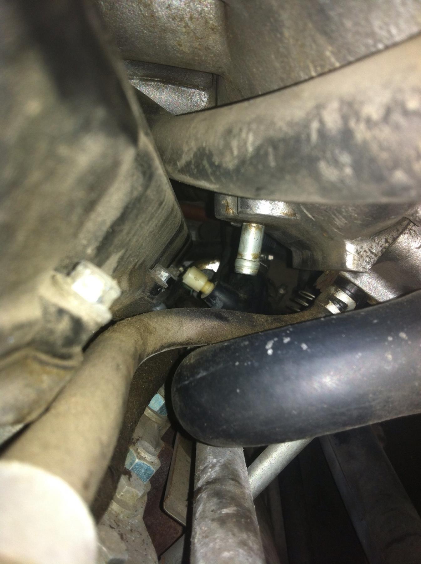

Difficult to see in that picture, but my 6.0L has 3 hose connections off the LH manifold. The front 2 are capped off and the rear connects to a metal pipe that runs under the intake manifold with another rubber hose that connects to the jackshaft cover under the throttle capstan.

I thought a picture was worth a 1000 words

Hmmmm......looks like it was capped off then.....and the other thing is a distributor vent, interesting!
Thanks a tonne guys!
