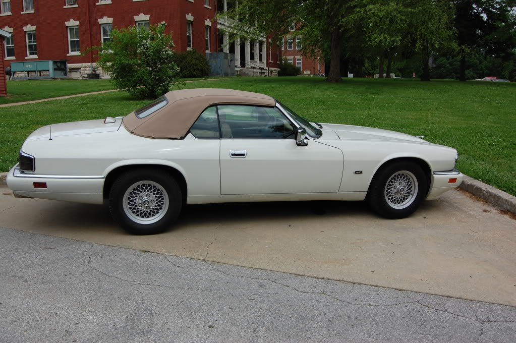

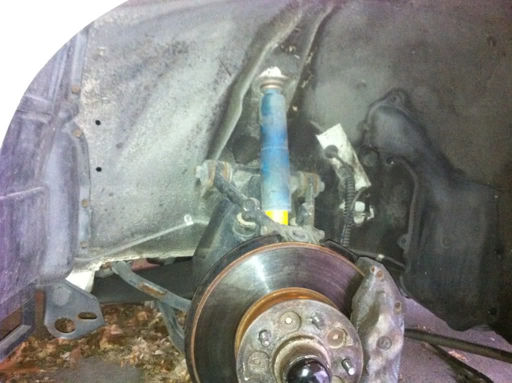

Finally got around to pulling off the front wheel and was surprised things looked pretty good. The shocks looked fairly new and were bilstein. I had been thinking the the front was sagging but now I think it may be that the back is riding a little high. The 'bounce test' was good. How do you check the ride height for correctness?
There is still a clunk on the driver side on turns occasionally. What should I look for with that?
Bit hard to tell from the pic but it looks to me as the rear is high. As a wet finger test you should be able to put your fingers on top of the tyre and the back of your hand should just touch the wheels arch.
There is a mark on your sway bar check that it is centered if not it can hit the disk on full lock. If not check ball joints and wheel bearing.
cheers WJ
Judging from this I would say that the front is correct and the rear is high. Is this anything to worry about and if so, how do I correct?

No expert by any means, but the rear looks high.
The distance to the ground from the rear of the sill looks to be even more than my XJ40, but this seems to be also pushing the front valance down a little.
Dumb question, but have you looked at the tyre sizes front/rear?

The front ride height was correct using warrjon's hand test. The rear has a lot more clearance. IIRC the tires are all the same 236/60r15. Was going to check the suspension on the rear but the rear wheel was seized and I was out of time and energy to wrestle with it.
