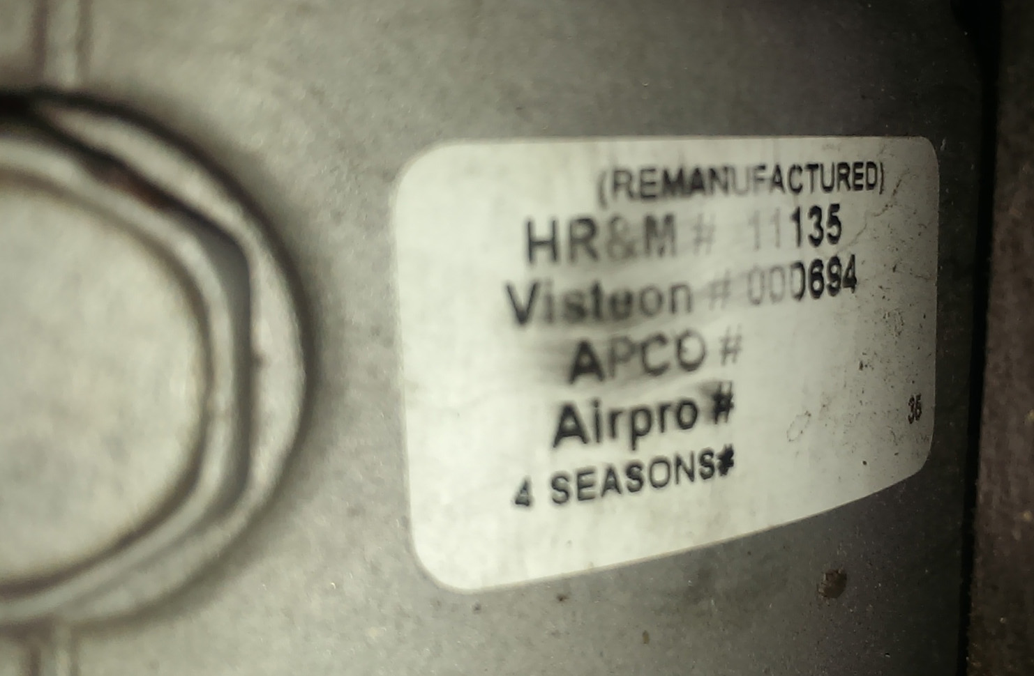

Attached is a photo of the label on the remanufactured AC compressor. I can't make it head or tail of it and can't find the equivalent.
Can anyone help me find what I need.
Thanks in advance

The compressor currently in the car is a remanufactured Four Seasons unit. So probably not the original. The photo attached are the only model numbers I have to go on. I'm beginning to think that the MHE7300BA is the correct part but that the supplier sent me the wrong part in the box.

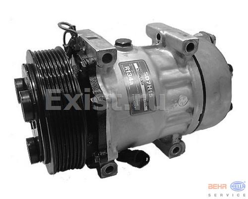

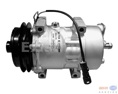

3 years ago I bought this. Only had to put the old pulley.

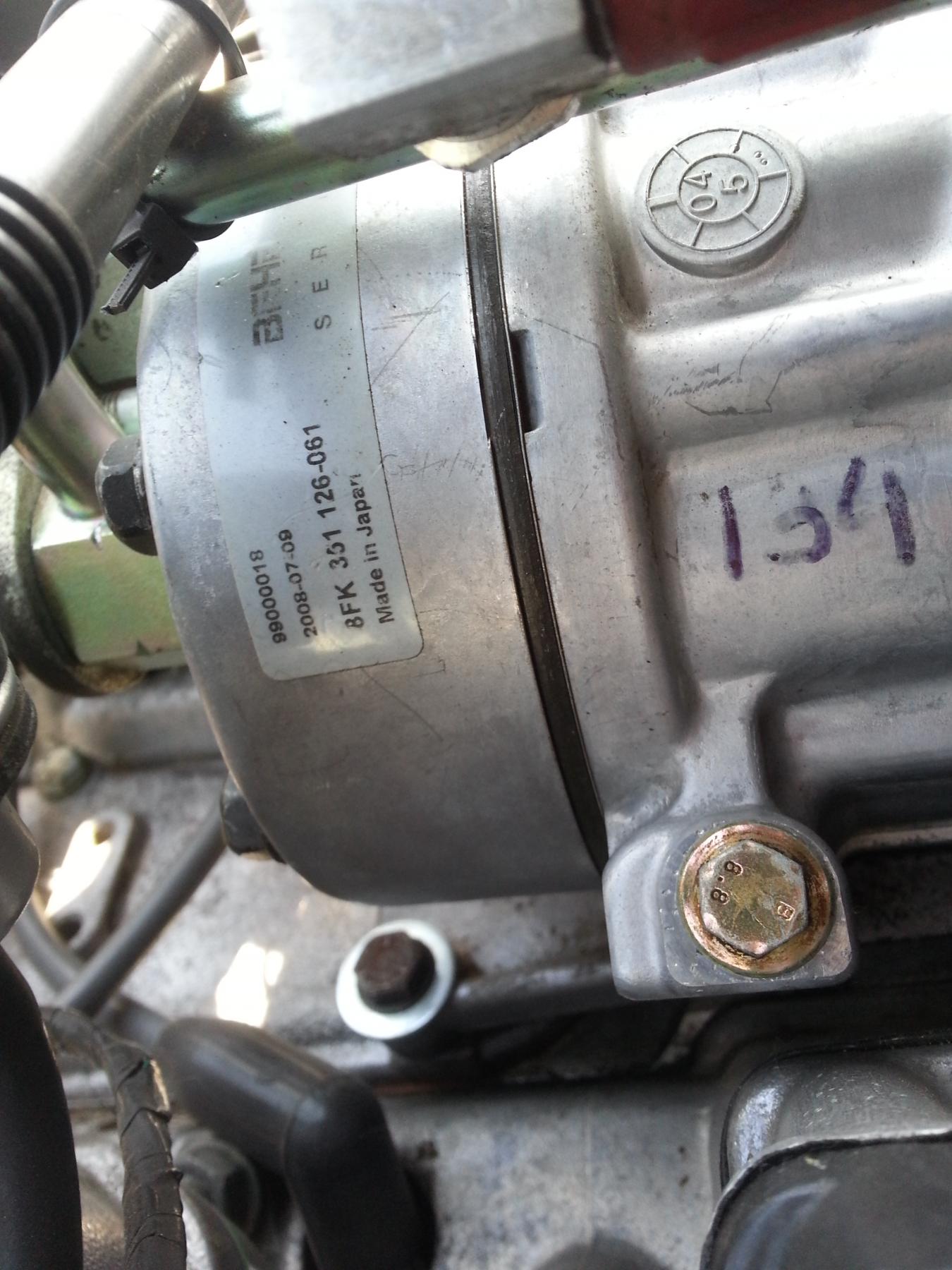

The original view of the compressor Behr-Hella 8FK 351 126-061. this is XJ40 V12 = MMC7300AA
You need to put the old pulley clutch and an electromagnet.

Behr-Hella 8FK 351 134-191= MHC7300AA
