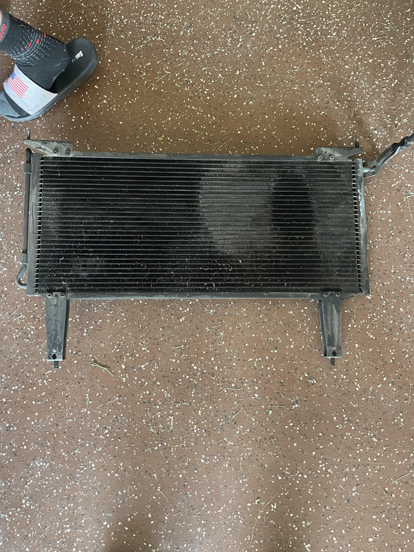

1994 XJS 4.0 L. I guess if you could have AC problems I had them. Both the high side and low side ports leaked. No problem on the low side, you can get that anywhere. The high side however in my case leaked at the solder joint. Thank goodness we have a company in Colorado called "Maxair" who could rebuild the hose. But it didn't stop there. The condensor was covered in oil streaks from multiple pin holes.
Took it my radiator shop, it failed a pressure test.
https://i.postimg.cc/tgGhWzFt/condensor.jpg

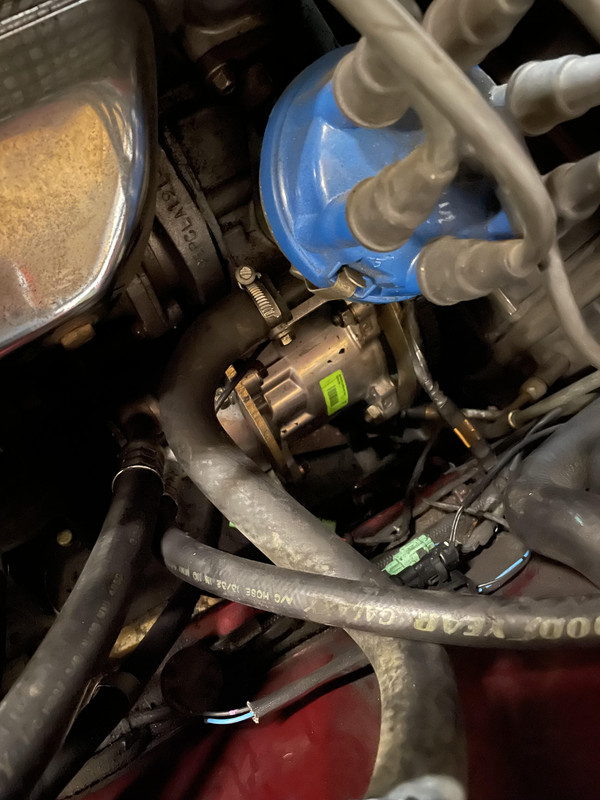

Well, what now? Turns out the compressor was covered in refrigerant oil on the bottom. So new compressor, for the 4.0l these are easy to come by.
Ok now the system has held vacuum for three days, time to recharge. Not so fast.
Evap seals are toast. Out comes the dash and everything to replace some o-rings.
Where are we today? Just a smidge above 45 in 100 degree heat. Do I regret it, yes.
