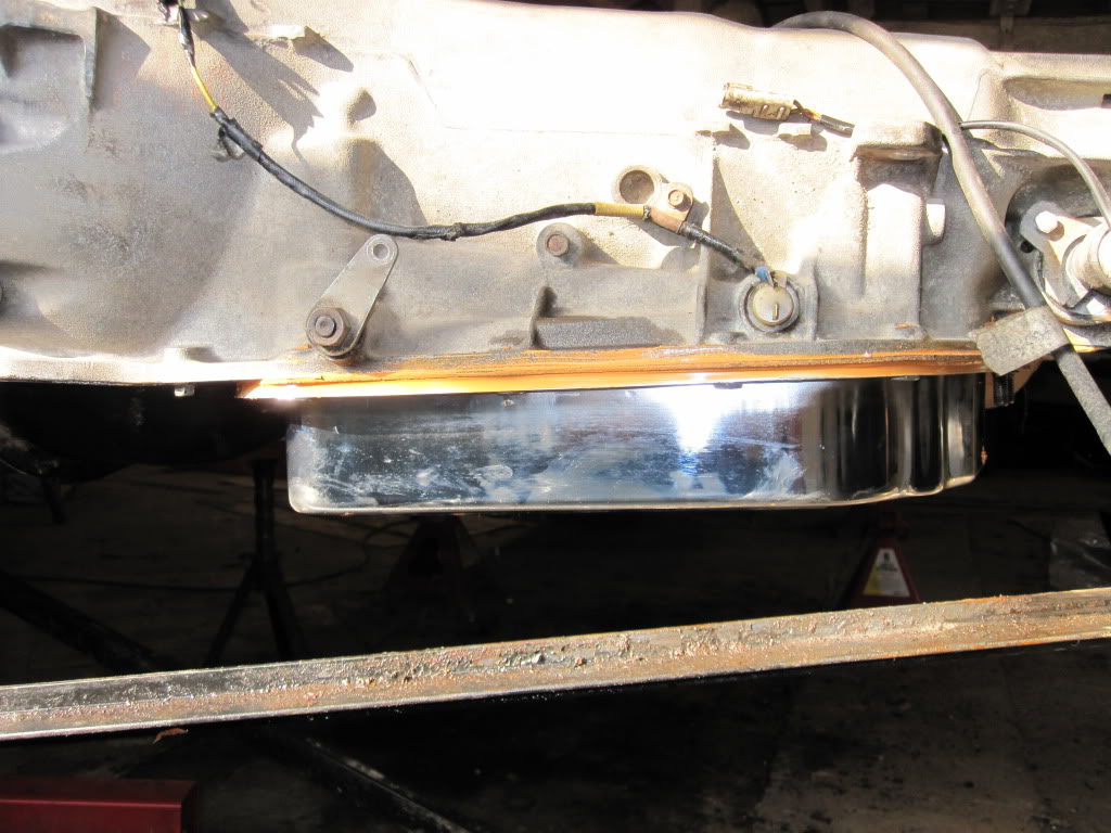

Assuming you have the three speed auto, It is quite likely that the KD is not in fact working at all and the box is changing down on its own. From your pic it looks like the switch is already asking for KD, even though it should not be. The KD switch works by means of a small lump on the cable that, when the go pedal is pressed right to the floor, pulls against a spring-loaded bit in the tube attached to the switch holder and thus pulls that lump against the switch arm and trips the switch. This circuit then strips an electrical solenoid on the UK passenger side of the gearbox.Yours looks from here as though that mechanism is stuck. VERY common after a layup.
Undo that flat thing with the KD microswitch in it through which the cable runs by undoing the two nuts (one each side) that secure it to the capstan. Look at the switch which is underneath and is secured by two tiny bolts. Pull off the leads (there should be two) and test the switch with a test light and see if it works. If not buy another. Next (regardless of the outcome of the first test) you need to see if the mechanism on the cable is working. If you cannot pull the mechanism to trip the switch and letting it go does not release it, the mechanism is jammed. Souse it in the mixture for a few days and then liberally WD40 it, pull it in and out and it will free off.
Once this is OK, reinstall switch, wires (orientation does not matter), and set it up using the two fixing nuts to the capstan so ther is no slack in the cable at rest. Then get the GF to floor the throttle (ENGINE OFF) and see if the mechanism and switch trip OK.
Then test the car and see if it kicks down. If NOT, then it is either the wire to the gearbox solenoid, or the solenoid itself that is the trouble. Post again at that point, but here is a pic of the solenoid attachment to the gearbox, so you can at least check that it is attached. It is the wire going to that round thing with the terminal on it towards the rear of the lovely new deep sump pan!
Greg

Hi Greg Wow!
That is one Sumptuous Sump!
When I floor the Throttle at any Speed under 60 mph She takes off and goes like a Bat out of hell but if I'm already doing 60 mph She just accelerates in the normal way.
So how do I tell the difference between the Kickdown Working or the Gearbox changing down on its own? I didn't even know that it could do that!
Is the Kickdown supposed to work at any speed?
