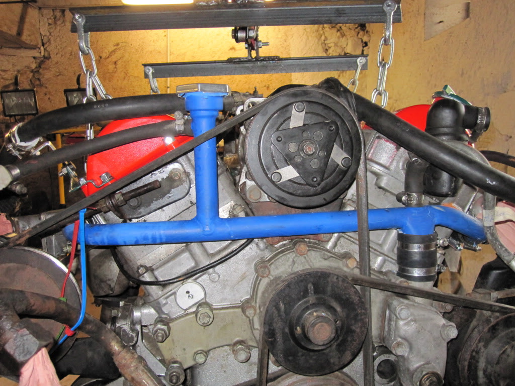

Further to Grant's reply, are you saying that the opening into the top of the water pump from where the cross pipe would go was open, fitted as in this photo:
If so, loosen the fan belt and see if you can spin the pump by hand. It is just as likely that the bolt has fallen into a thick bed of crud on the cross member below!
