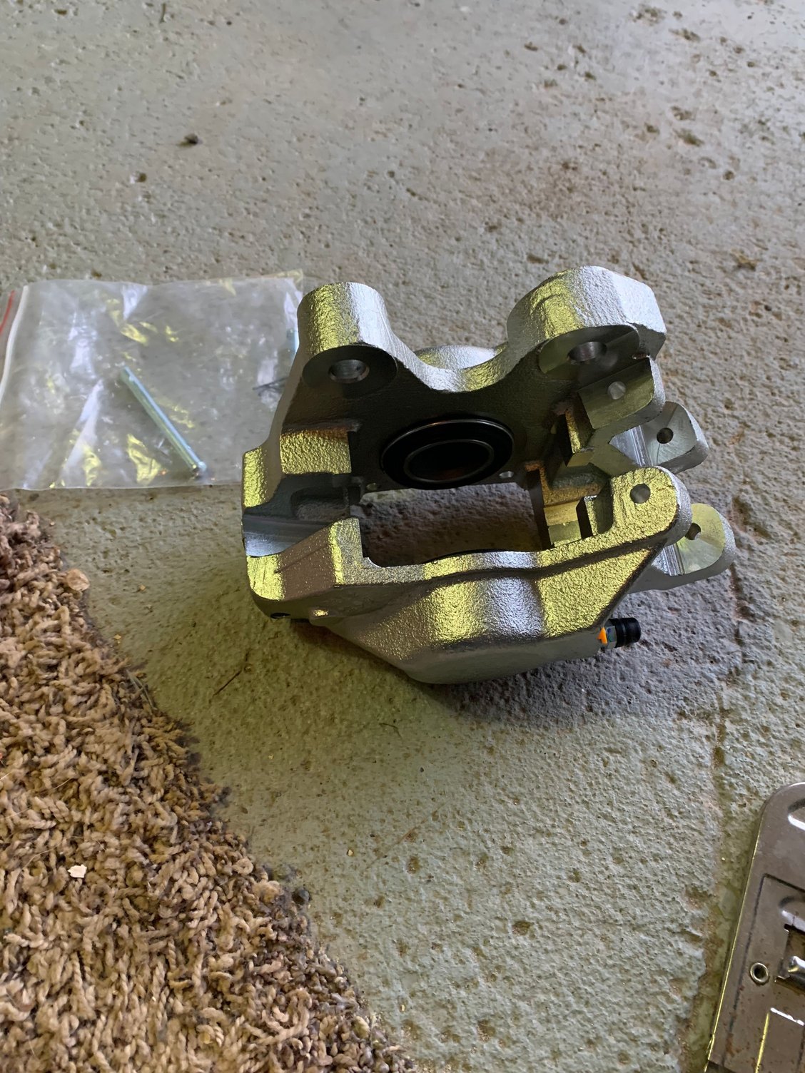

Thanks for the feedback. I ended up ordering "Auto Part Premium" brand aftermarket calipers. I could be wrong, but I'm guessing most or all of the aftermarket calipers are made by the same company. The stock photos all look the same. I'll report back on quality. One side was $45 and the other $72 for some reason, so not a bad deal if they last and perform well.
Why do you think the aftermarket rotors should be avoided? I'm not dropping the IRS, just doing the calipers and pads because the rotors are still in good shape and I want to start driving again, but eventually I will drop it during the winter months when its off the road.

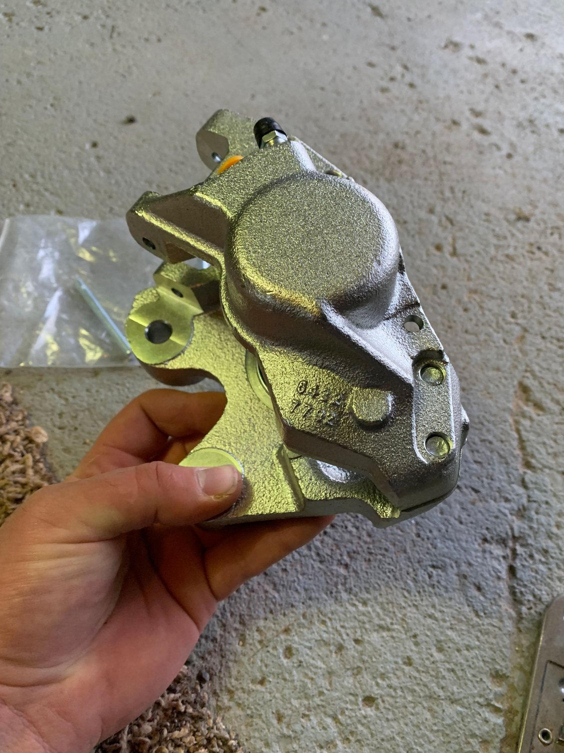

I picked up a set of rear callipers from SNG Barratt a while ago which are 'Budweg' branded.
They do appear subtly different to the original Girling ones on the car - for example the big 'G' in the casting on the outside face where the piston is doesn't exist on the Budweg calipers, some of the other parts/machined faces of the calliper are subtly different etc. Maybe this is something Jaguar themselves changed for certain years, not sure.
I do wonder where they get them to refurb though, when there is no 'core' charge?

They look to be new and not a rebuild, but then again they may just do a really good job rebuilding them
