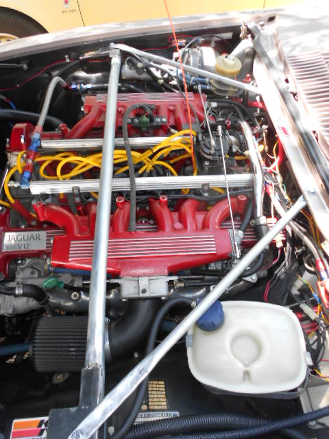

my fix was 12 New injectors from a company in California, we did some research into the flow requirements close to jag,slightly higher volume, and came up with a resonable cost for 12 new inj.

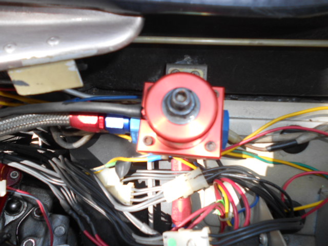

but i had to make a new fuel rail, aluminum,(pix enclosed) and an adjustable pressure regulator.

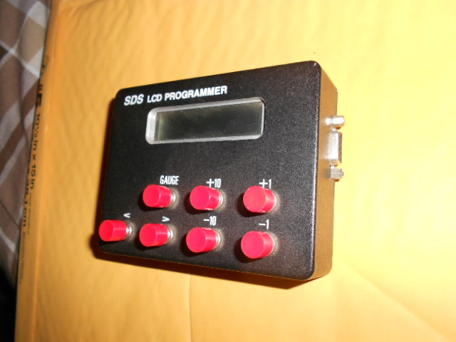

altho i also use a standalone fuel computor, to make things more adjustable and smooth, a hand held box, works great been upgraded twice in 20yrs!

Are those intake elbows metal, or, are they polycarbonate, and, where did you get them? Looks like you were able to drill & tap the left one for the air temp sensor.

the intake elbows are steel, as i remember ,i was at a truck repair shop, and parts counter had some 90* 3" inside dia. tubing elbows,tite bend, had to cut off some ,welded to a flat steel plate(homemade), bolted right up to manifold TBs, and two simple K&N filters!
for air sensor i drilled the manifold, where the old cold start injector was(not needed with standalone com. is adjustable).
and the injectors were for a Honda engine,O-ring top and bottom, never did like that silly Bosch with a hose on top(dangerous engineering).
