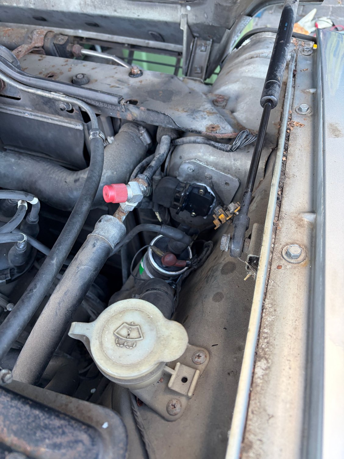

I spent the day tinkering with dads jag xjs (1991 early facelift 4.0), hoping to get it running and then change the gearbox ecu (see my other thread) but the first thing to solve- it won’t start.
Dad had it idling on the drive a few weeks back and it cut out and wouldn’t restart, the AA man he called a few days later reckoned it was either the coil or the ignition amplifier.

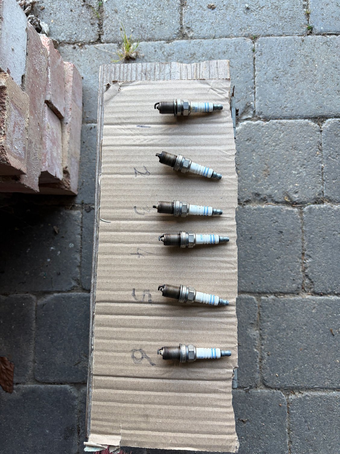

So this morning I replaced the plugs (I tend to do this as a matter of course when trying to get a temperamental car to start) ignition amplifier and coil, testing to see if the car would start after changing each component in turn.
No spark. The coil and amplifier have 12v with the key on. My next suspect is the crank position sensor, which I removed and cleaned but don’t have any way of testing. I’d buy a new one if local places had them on the shelf, but of course it’s too old a car for that.
Any other suggestions before I order a crank position sensor online? I’m only here for the weekend, just wondering if there’s anything else I should try.

Ok, a friend went and swapped the crank position sensor for dad (I live a long way away and couldn’t just pop back to do it).
still cranks with no start, the rev counter isn’t showing any difference when cranking- ie it just reads 0.
I suspect it still has no spark, although my friend left before I could suggest checking for one and dad can’t check on his own.
is there an obvious ecu fuse? Or something else to try? I thought I found all the fuses, but the car has several fuse boxes and they’re not labelled which is fun…
it’ll get towed to jagutech next month, but if there are any suggestions of something obvious to try first let me know…
