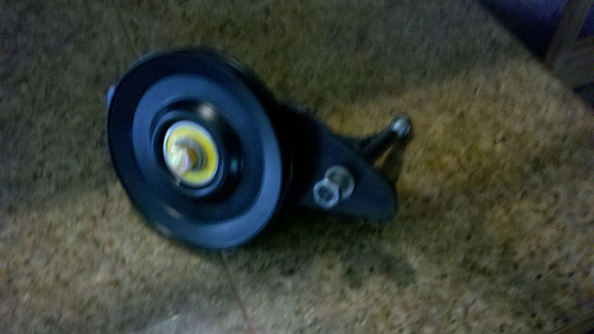

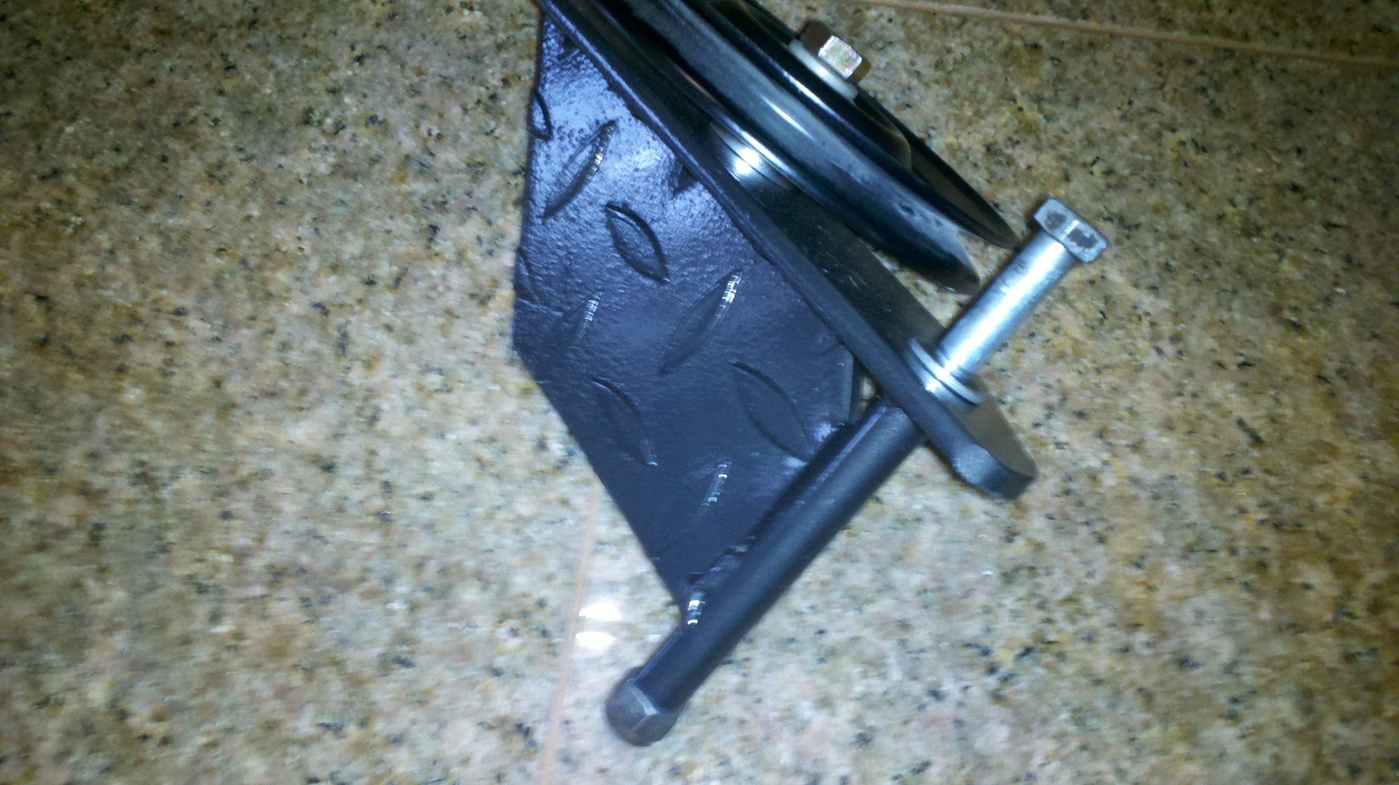

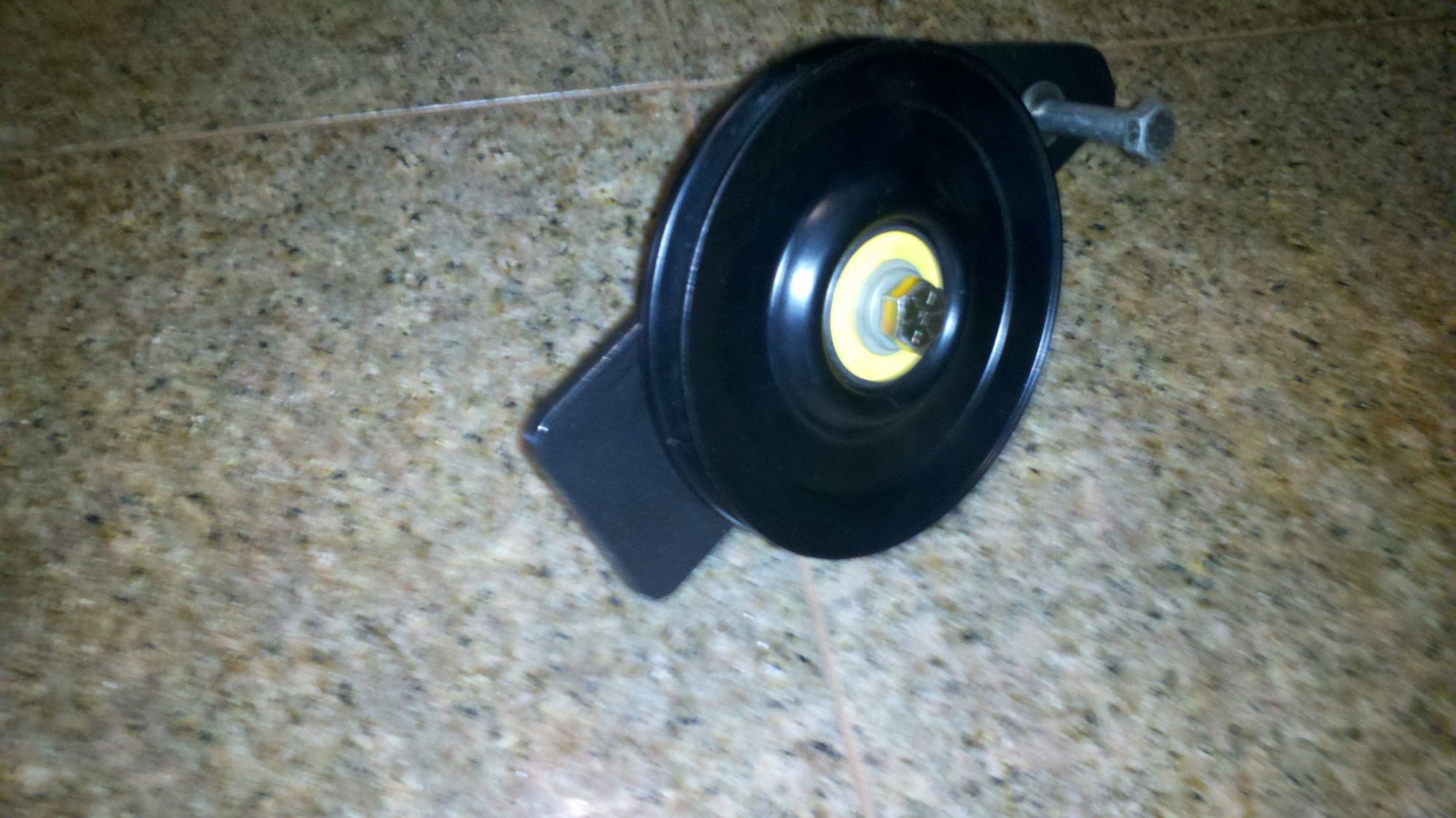

Originally Posted by The Cat!
I will try to post (later tonight) a picture of my solution for the smog pump itself. I wanted to keep my AC, so I devised a pretty simple way to do that.
Easy solution. This bolts on in place of the pump.

I have had bad luck with my eldorado's smog pump. Last winter, when it was maybe five degrees below zero outside, one of the fiber impellers decided to fall apart inside the housing. The pieces got wedged between the other blades and the whole thing seized up and destroyed my serpentine belt. I had to make poorer version of your pulley solution just to limp the car home. Now I look at those pumps as enemies.

There are a lot of creative ways to replace the pump. The hardest part is probably finding the right pulley with sealed rollers in it. The one I found is a pretty good match.
Gates part number 38004.
Canadian V12 cars had that pulley for many years when air injection wasn't required.
