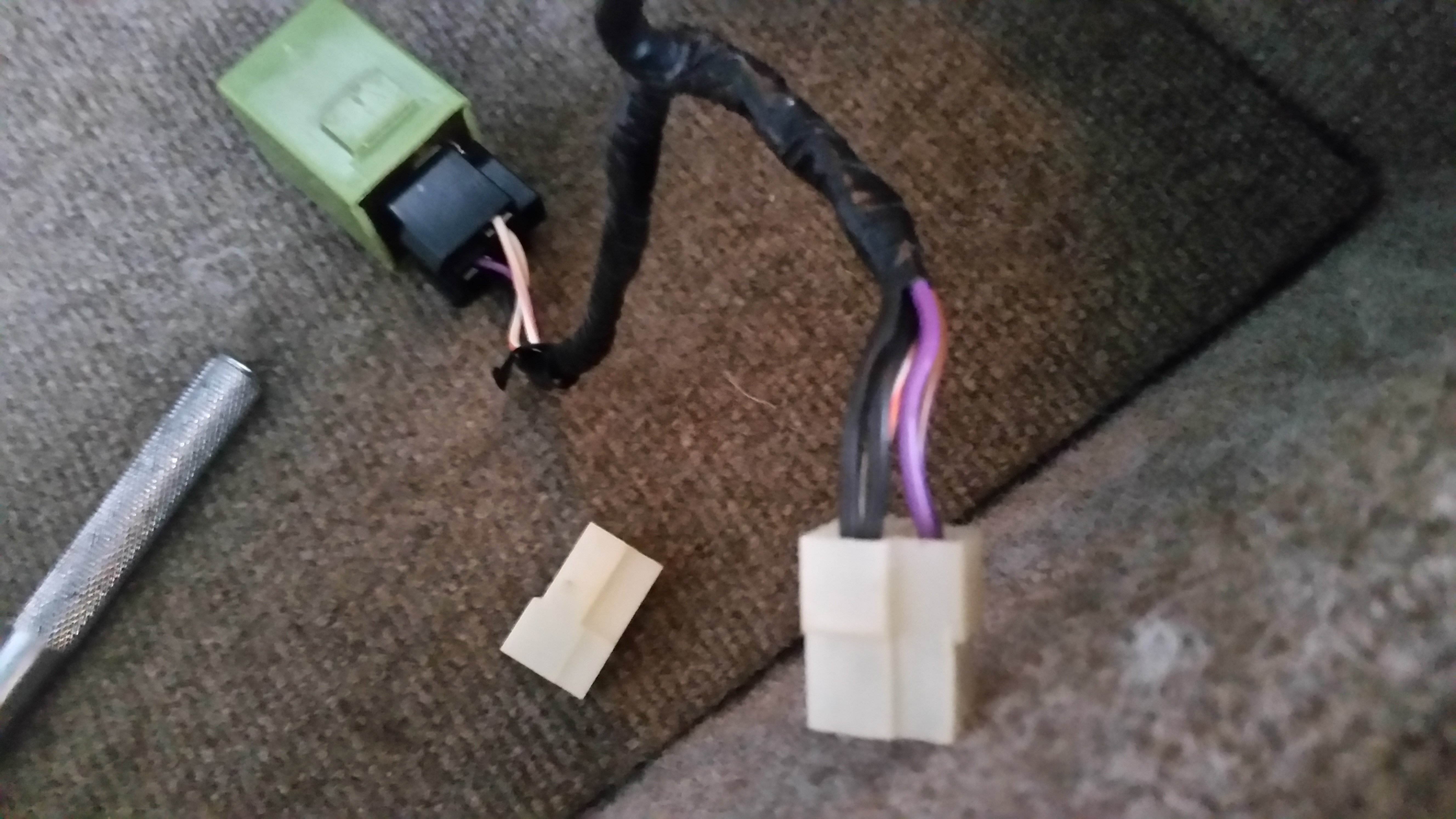

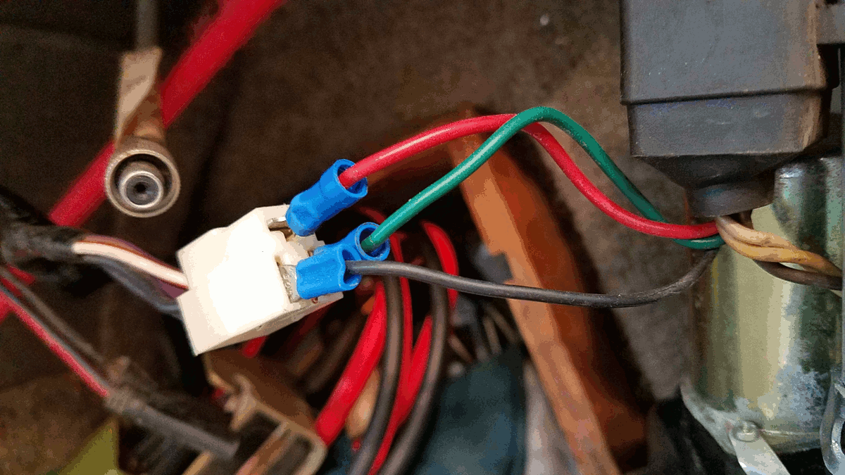

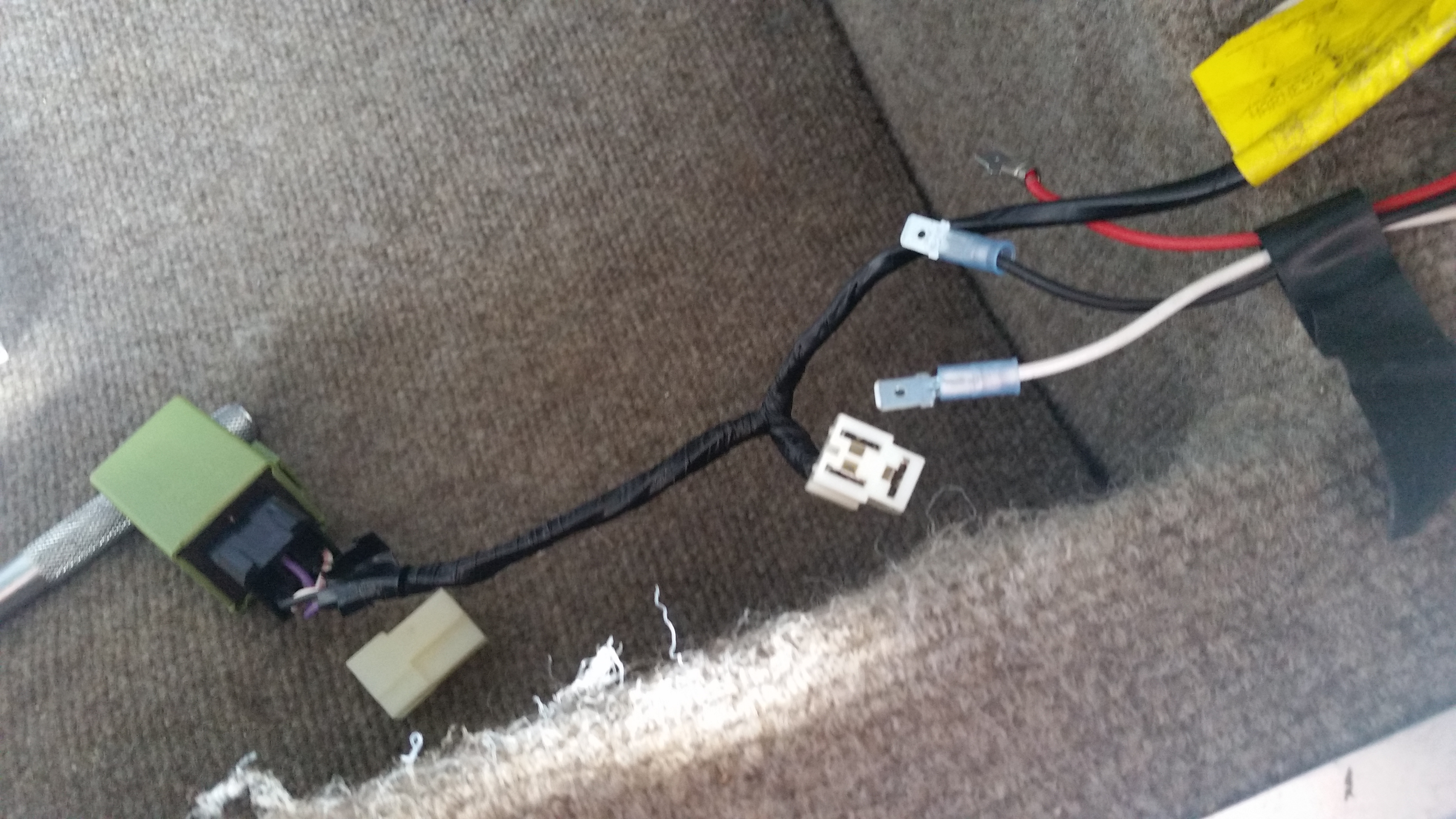

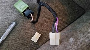

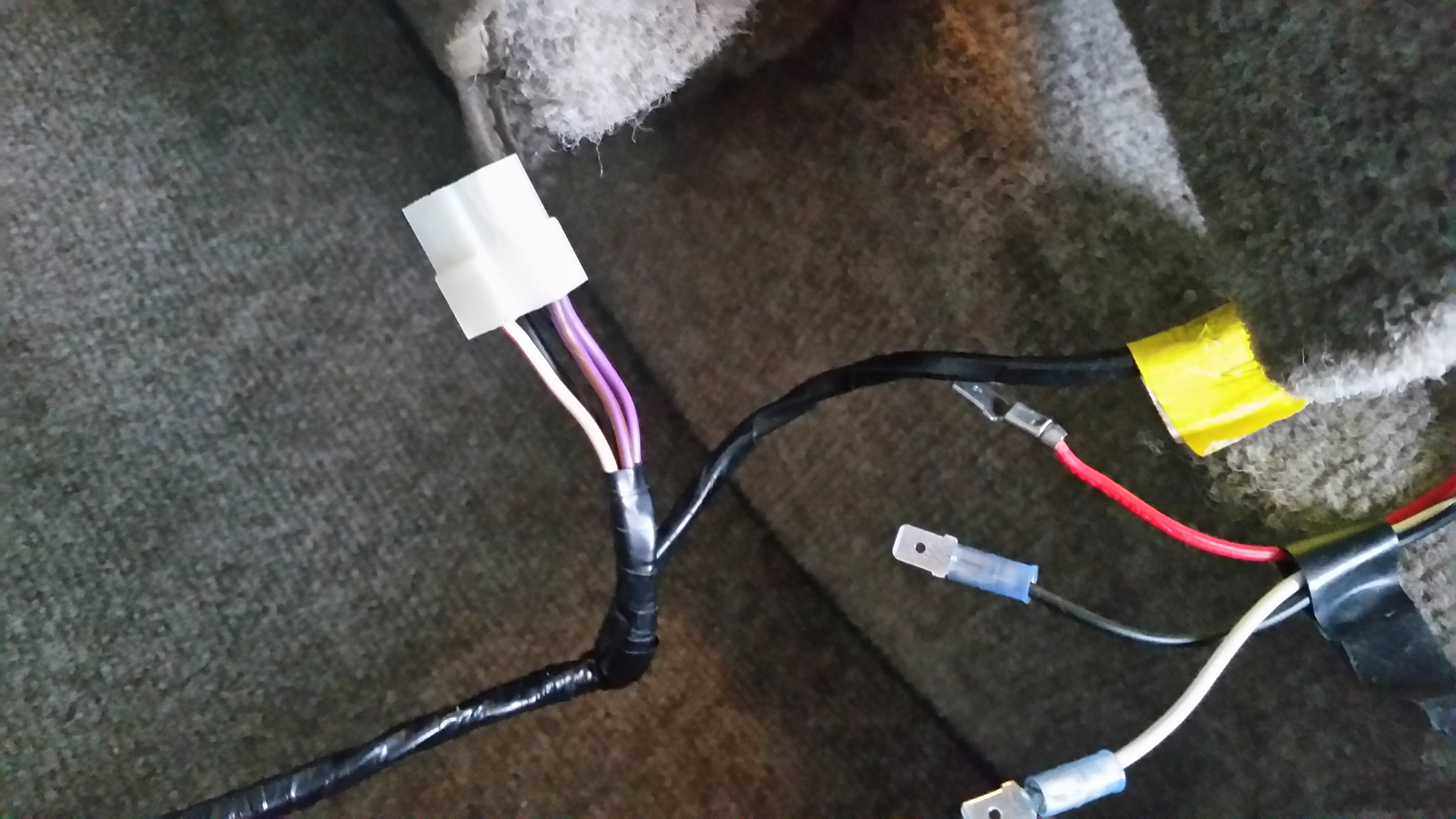

I have almost finished installing a new antenna and then I did something stupid, which I know better. I did not take pictures along the way !! SO here are a few pictures. My question is "for the red, black and white wires, where do the go in the plastic coupler", i.e.which one in on the top then on the left side and the right side.

Here ya go.
I don't have a white wire.
John
