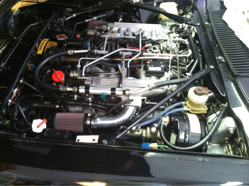

I'm running the K&N "growler" intakes from V-12 performance. There was a drone at highway speeds then I had the shop put the "H" pipe in. Drone gone.
Here's a picture of them
