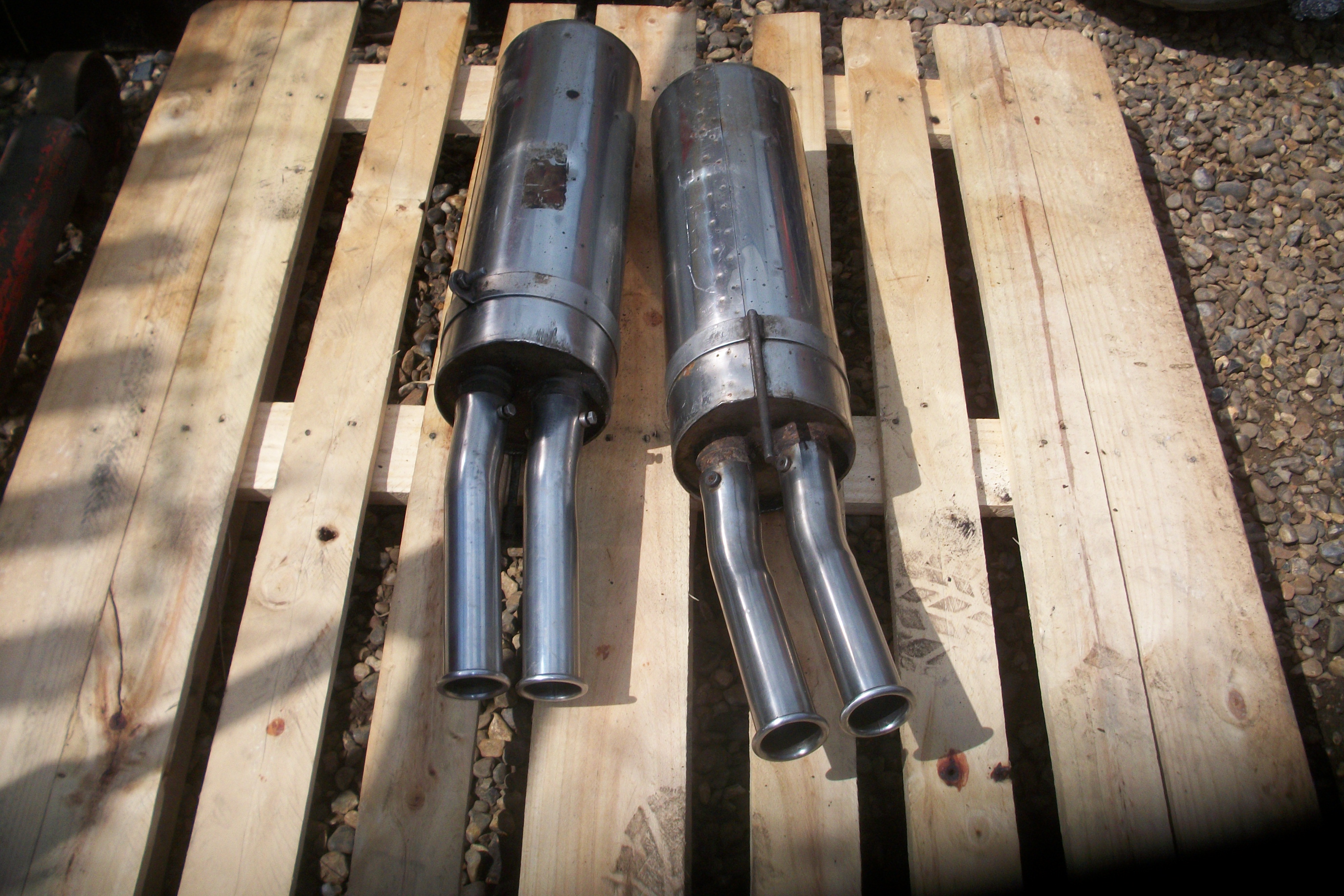

Centre box replaced by straight through pipes and TWR rear boxes fitted, sounds really good.
Attached Thumbnails Exhaust change (1992 XJS convertible) - guru pulse check?-100_3201.jpg   Exhaust change (1992 XJS convertible) - guru pulse check?-100_3689.jpg

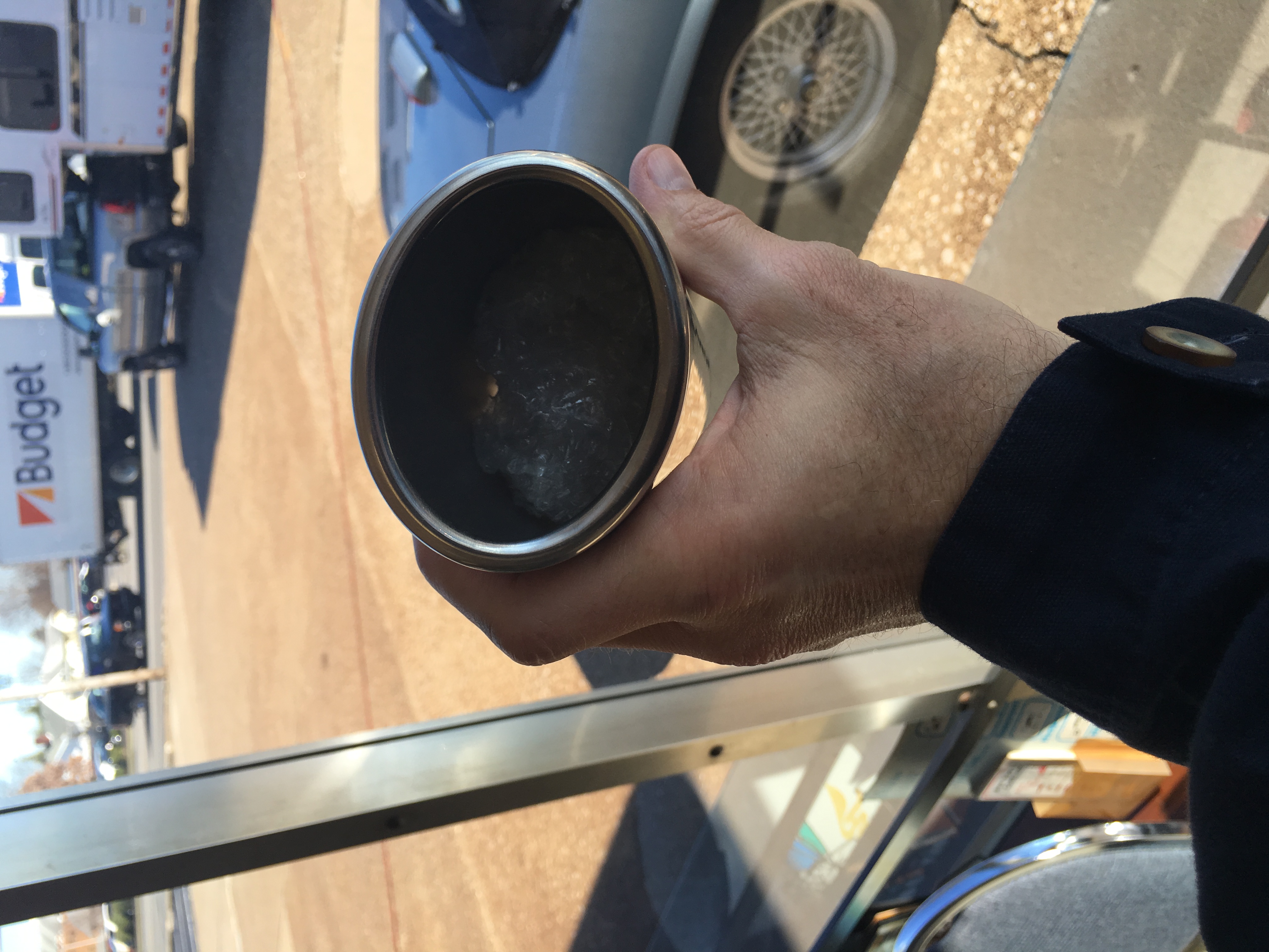

Update: my new Mgnaflow mufflers were installed last week and I'm very satisfied thus far. Still need to drive him some more to get a better assessment of things (mid-high speeds), but the "normal" city driving/idle sound is really nice.
I'm hoping my pics and video display well. Included: the model number of the mufflers. An "H" pipe was also utilized (as depicted). The tips are also Magnaflow.

By the way: the old resonators/mufflers were removed.
The material that appears inside the tips was packing material (removed, of course) - they are not resonator style tips (just straight-through).
