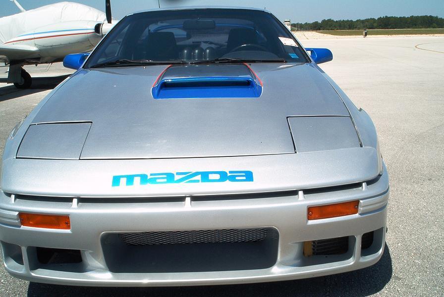

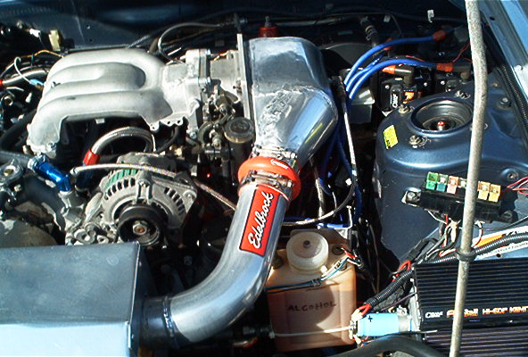

i been using EVANS water less coolant since 1990, never had any problems, even in a hi-boost turbo rotory Mazda RX7. they have a nasty tendency to spike local chamber temps almost instantly, and go BOOM instantly(detonate) no warning.
Evans saved more than one engine,after i learned more about there peculiar traits!
but 500hp out of 1.3L is unusual also!!!
i highly recommend it!
