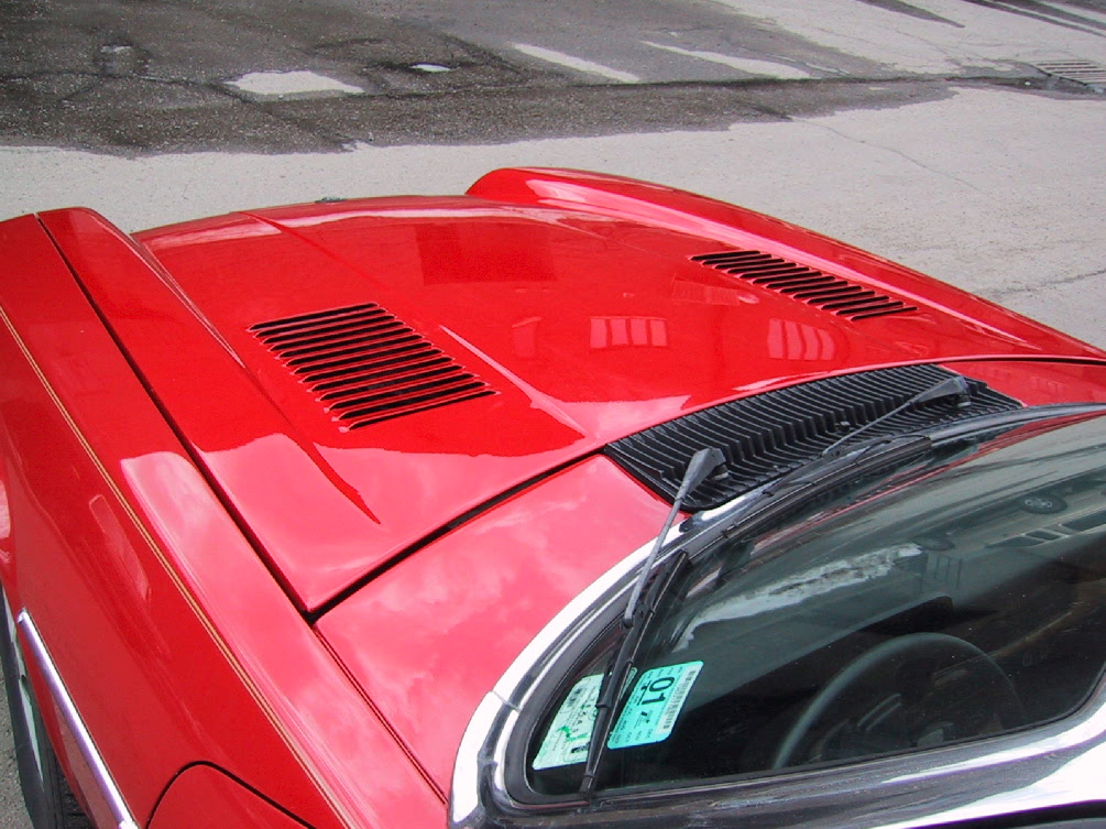

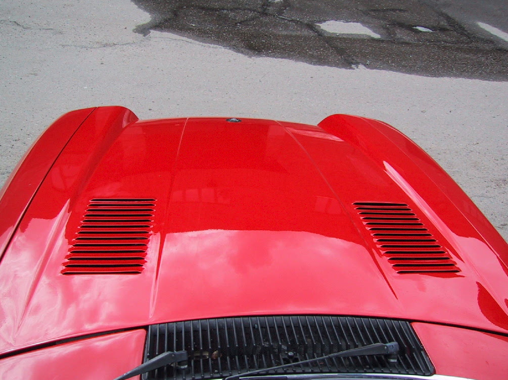

So perhaps you can understand my frustration with the overheating of an XJS. With proper air flow and the current cooling system there should be no reason for overheating. Instead we have a small grill area and no where for the hot air to go in such a cramped space. I'm actually tempted to cut into the hood and install small exhaust vents or route hot air exhausts from the "V" area to under the car. Even two 2" flexible vents would improve the total air flow greatly.
Right now I always reach down and unlock the hood every time I park. You would be amazed how much convection air comes out.

I am keeping my eye out for something a little more in keeping with the lines of the car but yes. like that.
Hopefully a set of vents that can drop into a cut hole and would not require re-painting the whole car.
