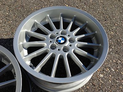

some 15 spoke alloys

some 15 spoke alloysBMW 528i 540i 745i 740i 18 WHEELS RIMS M style 18X8 5 SERIES

some 15 spoke alloys 18x8

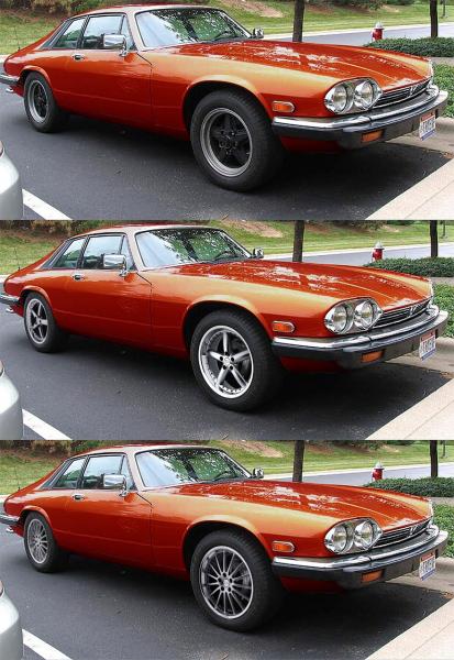

What do you all think of these wheel situations:
18x8 5 Coventry Hornet 5x120 65 5x4 75 30mm Gloss Silver Mirror Rims Wheels 18" | eBay
18x8 5 Coventry Whitley 5x120 65 5x4 75 30mm Hyper Silver Mirror Wheels 18" | eBay
Specs seem to be perfect for mounting, not sure about clearing the wheel wells.

Of the three, I like number 2 the best, but for mine, I am looking for something that resembles the factory "lattice" wheel but in a 17"x 8" but I do not want to pay for the BBS RS wheels. Those I like alot!

number 3
