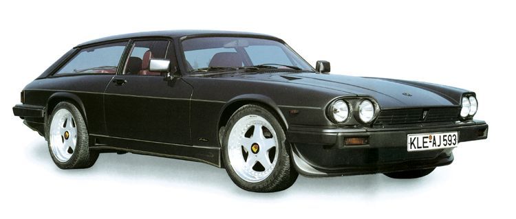

Alternatively, do you think that running 17x8J wheels with 225/50 R17 tyres (so just one step instead of two) on 8j wheels, with an offest adjusted within ET 25-30 with spacers to preserve suspensions, would give an acceptable ride?
17" rims were proposed e.g. by Arden specifically for XJS, albeit with specs departing more substantially from Jaguar specs, to give some more "sporty" look and ride, in particular regarding offset: 17x8.5J ET13 and even a more extreme 17x10J ET 19.
I attach a pic of an XJS Eventer equipped with 235/45R17 tyres on 17x8.5J ET13 wheels front and rear and of a coupé with the larger rims on the rear.
Arden actually rebranded OZ Futura rims that can be found aftermarket, including with less agressive specs (e.g. 17x8J ET30).
I would be tempted (nice look and acceptable ride).
What's your opinion?
Attached Thumbnails Aston Martin "DB7 wheels on xjs-arden.jpg   Aston Martin "DB7 wheels on xjs-xjs-arden.jpg

17 inch would give a better ride than 18, but why go bigger anyway? Lots of modern Jaguar owners report that, even with all the modern suspension trickery, their cars are pretty uncomfortable on poor surfaces with the optional bigger rims that are offered. I would not go wider than 8 on the rims if you use the car in all weathers.
