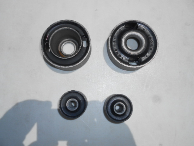

My car did the same thing. In my case, the back two
of the V mounts had unbonded, the large radius and small radius bushes had unbonded, and the inner fulcrum bearing rusted up and the fulcrum shaft had worn an oval shape into the rusted bearings. I guess what I’m saying is it took a lot for me to notice and it wasn’t all one thing! Very hard to check those inner bearings to see if they’re rusted solid. In my case, the bottom arm was clearly sitting cockeyed since the hole was oval.

gotta love these Jags, when i 1st got my 78 XJS ,didnt run, i was backing it off the delivery truck, and using the E-brake handle , its started to roll to quickly, so applied E brake!
the complete rear subframe/cage broke loose from the V mounts and twisted sideways, locked up the wheels against the body.
YES a lot of careful work and money before things were back together , my take is Jaguar never intended the cars to remain in service for 30/40 yrs with rust conditions taking place.
