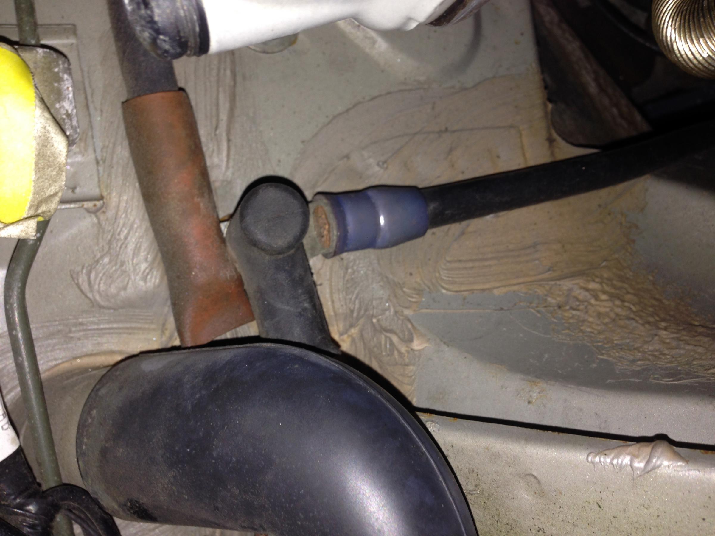

Default Battery terminal
Pls see attached pic.
It's a 96 XJS 4.0L conv.
Would this be the positive battery terminal in the engine compartment?
Attached Thumbnails Battery charger/maintainer-eng-bat-term.jpg
Old Mar 13, 2015 | 02:52 PM
scarbro2011's Avatar
Joined: Jan 2011
Posts: 302
Likes: 92
From: Snellville GA USA
I use a DVM (Digital Volt Meter) to check voltages before making connections.
DVM's are not that expensive now. There are coupons on the occasion at discount
hardware stores like Harbor Freight where you can get a DVM for $0.0 !
I have several DVMs as part of my tool kits.
You should read +12.6VDC or better without the ignition on at the firewall
connection. Trust, but verify!
