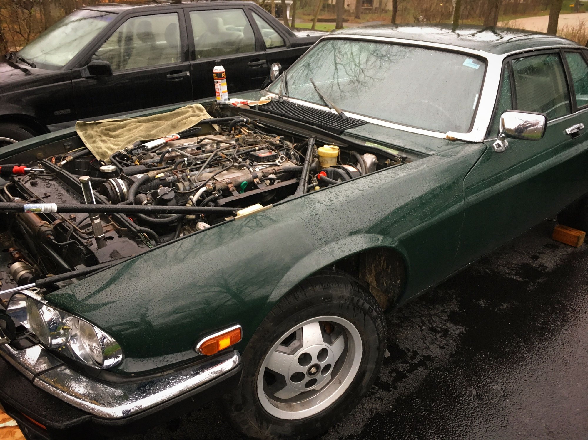

When it rains it pours... I found the alternator belt. It's nicely wrapped around the crank pulley assembly on the inside. I can't even see which direction it's wrapped or anything. Just have half the belt hanging and I cannot get it out. I think I'm going to have to take the crank assembly off. Haha what a nightmare.
Old Apr 10, 2017 | 04:07 PM
944xjs's Avatar
Joined: Jan 2017
Posts: 678
Likes: 106
From: Illinois
Got it out. It was just crammed in there so good. Took everything I had to get it
Old Apr 10, 2017 | 06:15 PM
944xjs's Avatar
Joined: Jan 2017
Posts: 678
Likes: 106
From: Illinois
Haha and now it is raining... I feel like I'm in Britain let's test the Lucas's water resistance
