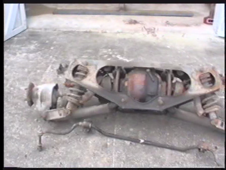

when taking apart my xjs for complete rebuild!
i found this rear sway bar on it!
some guys who were racing some xjs said dont use it saying car would handle badly!
it went into scrape heap! gone.
so now i'm having wiggling/fishtailing, maybe i should have put it back on??

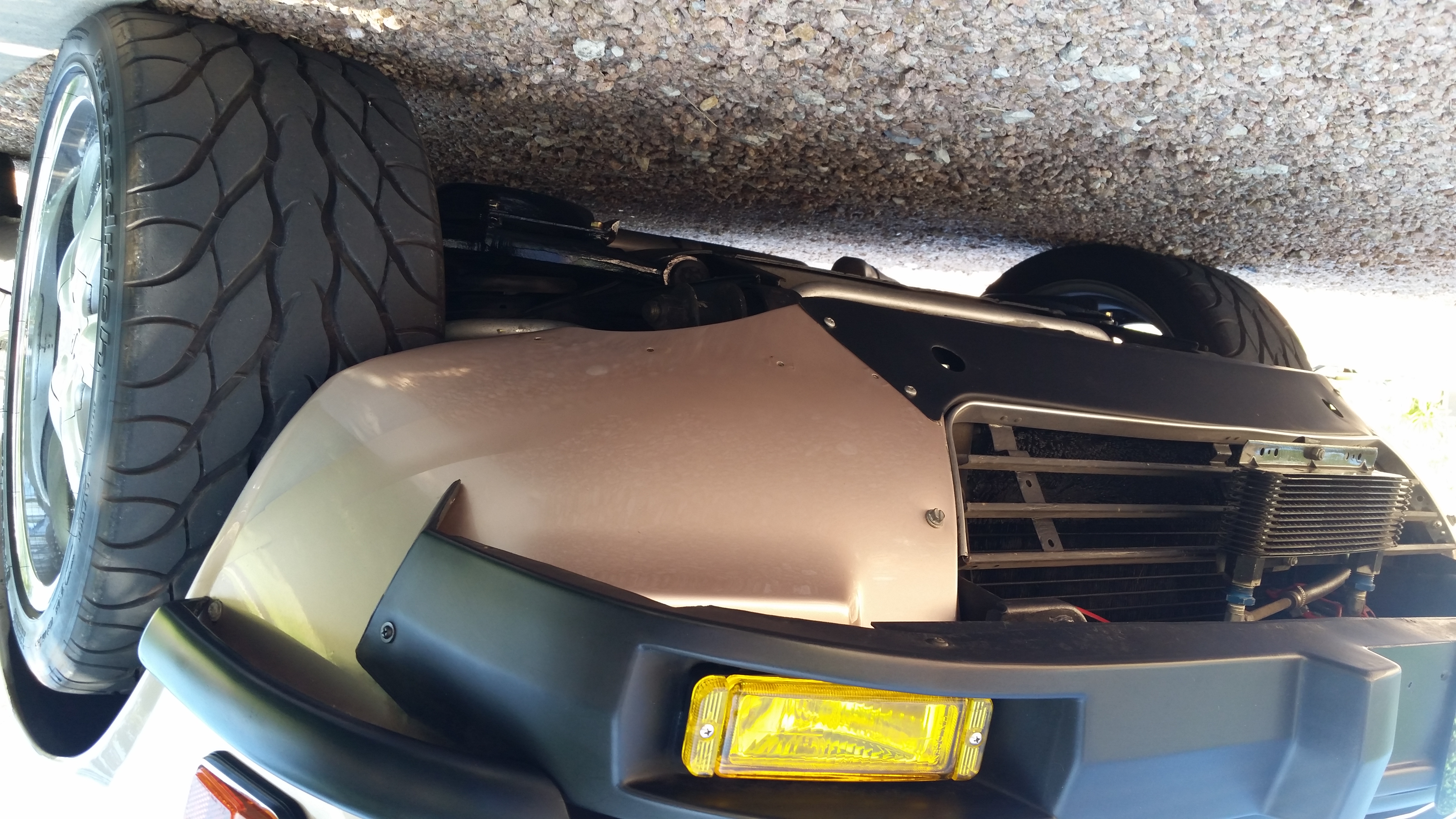

also pic of my front bar 1" inch diameter, it may be contributing my waggin *** end!
sorry upside down pic.

Hmmm. I wonder what it was from? From what I can see it doesn't look original.
Probably shoulda kept it!
Over the years a story has been floated from time-to-time that Jaguar stopped using the rear bar because 'track testing' proved the car gave faster lap times without it.
I dunno if that's true or not.... but the immediate come-back is (as always, and correctly) "What works best on the track doesn't always work best on the street"
No, that's not it. A rear bar will reduce under-steer and, if anything, will make the car *more* tail-happy if driven aggressively....doubly so if you go too large.
DD

Doug, That looks like a standard Jaguar rear bar to me.
Ron, I do not think the absence of a roll bar will affect the suspension on takeoff on a straight road - if this is what you are getting. More likely you have some play in (in order of likelihood)
  1. the outer lower wishbone fulcrums
  2. inner lower wishbone fulcrums
  3. hub bearings or driveshaft UJs
  4. springs/shocks going home a touch
  5. tyres ditto
  6. diff LSD
  7. play in your home-designed axle locators
Lots of fun to be had! My car about 10 years ago started to wander a touch on fast sweeping bends and I was always correcting the trajectory. rebuilt the lower outers, in which play was maybe just detectable, certainly not obvious, and cured.
Greg
