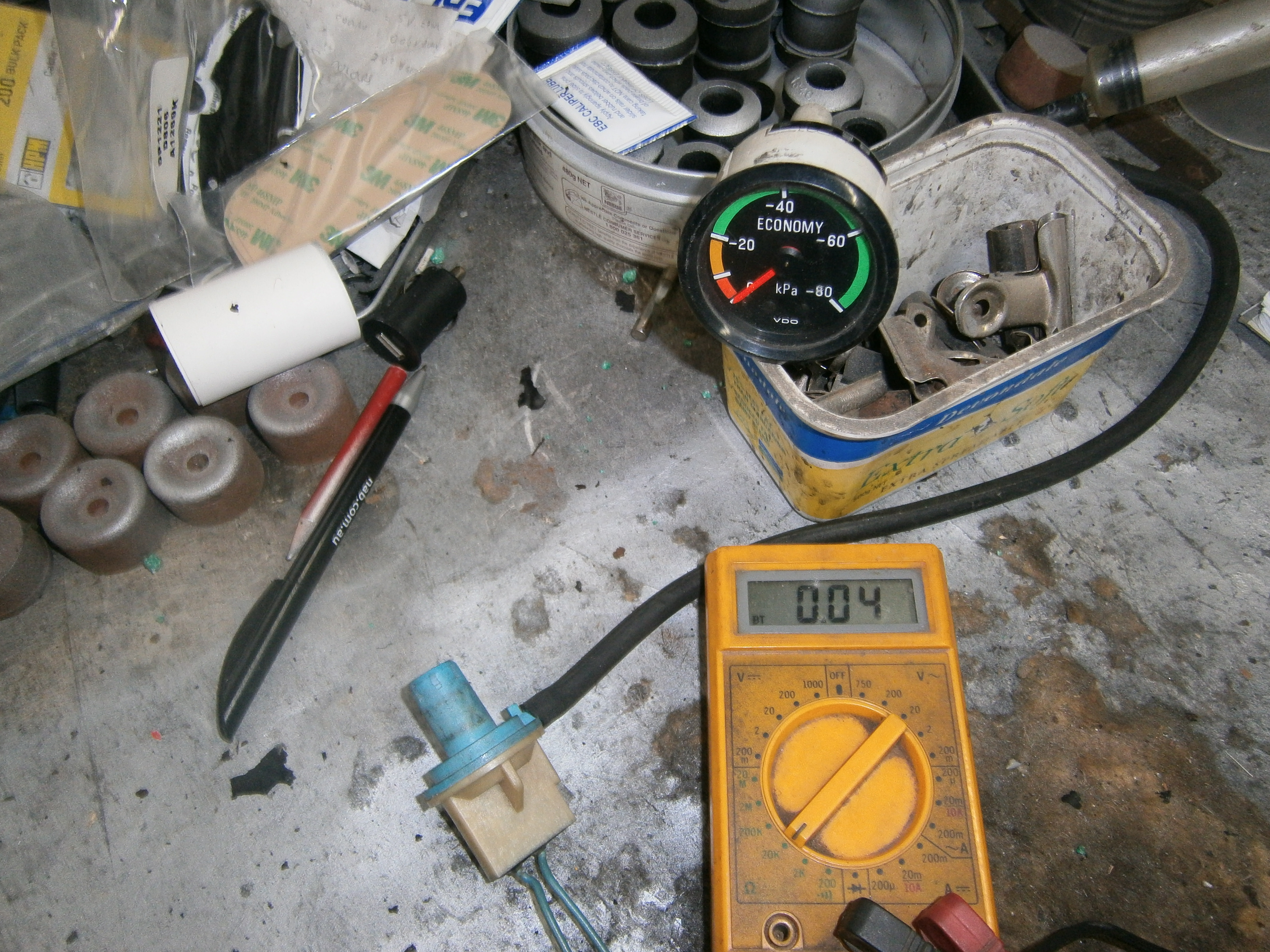

This is the Fuel enrichment valve I am referring to.
Attachment 207064

The gauge is a vacuum gauge. Typically for carburettors, there is a vacuum enrichment usually around 5" Hg. If you stay out of that range the carb isn't enriching, thus the "economy" marking on the gauge.
Some EFi systems do that too, the pic you posted Orange isn't a dump valve, it's an enrichment switch - again, it's sensing manifold vacuum and telling the ECU to enrich at low vacuum, i.e. heavy throttle conditions.

Yes its a Vac gauge and damn near as old as me.
I use it a lot for all sorts of trouble shooting.
In this case, I am adjusting that valve to suit an engine and driver requirements. The syringe is from the local "dealer", and simulates engine vac for what I am doing.
Simple, just like me.
