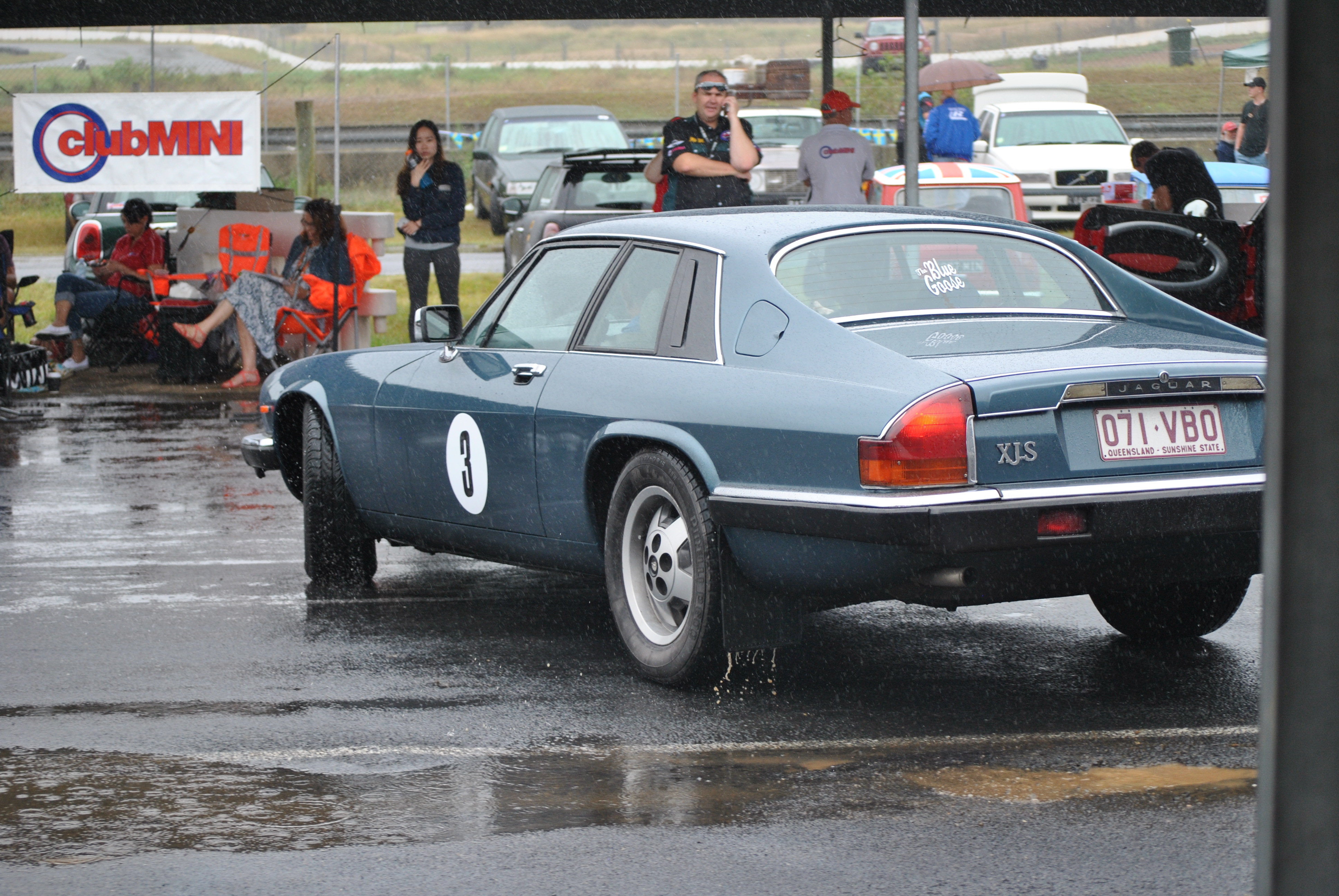

Originally Posted by Grant Francis
You only hit your head twice on those pins before you learn the art of ducking.
Yep, got a scar to prove it. The Blue Goose got me good!
