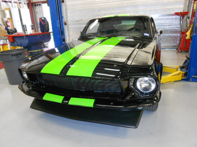

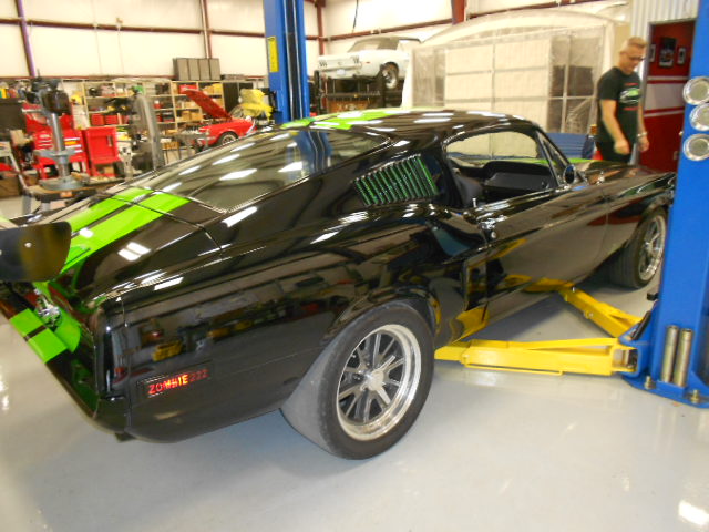

DIAM ; google Electric Mustang, Zombie 222,, that car is 1/2 mile from wher i live!
went for a short ride , 0-60mph in 2.34 seconds,, since then new grip tires, and some small computer mods , maybe world record 1.94 seconds 0-60MPH
, i see him at car shows locally, Sandeez hamburger Hut Austin tx.
he keeps all track timing slips case some dont believe it!
he also set a top speed standing mile , of 174mph, using highest rear gear ratio made for his final drive, and 2(two) overdrive units installed,30% each!
motors run out of RPM, but torque at stand still 1800 lbs ft, so you gear it for your needs.

padre, i have spoken with the mustang guy( Mitch Medford), i'm quite sure he can convert an XJS for around $100K (not $200K), lets not forget , he has much experience with electric cars, if you had it done it would be well sorted
and save DIY guys a lot of headaches!
he is right now doing a 1963 Lincoln 4dr hardtop, complete motors and drive train + plus all the electrics!
car owner said big old Lincoln barge 5200 lbs, was to slow driving around town, needed more TORQUE. 1800ft lbs should get it done!!
some info electric mustang,, he does NOT use any transmission at all,NO clutch either, its direct drive from elec. motor shaft to the drive shaft into the rear end, thats for the 0-60 runs!
for top speed he adds 2 two gear vendor overdrive units, he can change it over in hour or so!
he is going to add a third overdrive for maybe 200 mph(TEXAS MILE).
actually the DC motors peak rpm is around 3500 rpm, its the torque that has to be managed properly!
