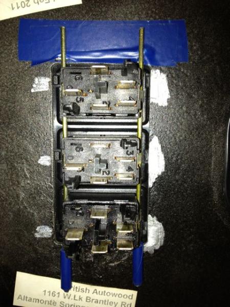

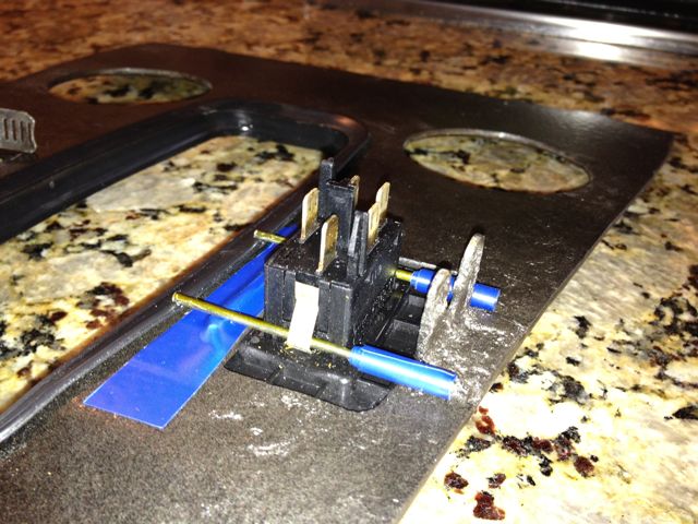

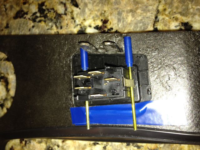

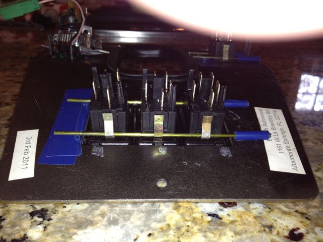

I finally had a few hours to myself and I decided to attack the sorry look of my ski slope switches, you know, the ones that are always popping out?
I bought a replacement ski-slope, with the cup holders from British Autowood. Well the thickness of the material (steel with wood veneer) is far greater than anything the bezel clips can tolerate , so I had to come up with an alternate solution.
What I did was take a wire hanger, not the crummy thin ones, but the thicker one and snip off some pieces. I then slid it through the switch clips. I then had to thicken up the ends because it was about .5cm off. Anyways, it worked for the windows and cruise control.
The cigar lighter was much tougher. I basically wrapped it in a rubber tape and used a hose clamp with some steel angles. There was still a gap, so I shoved in some more of the leftover wire hanger pieces, and it is locked in there. The problem is that its too tight for the cigar lighter itself. It gets wedged in there and is almost impossible to pull out. I must have tightened it too much. I also covered over the light bulb, so that's going to need a LED conversion... I'll get to that next time I have more time.
Its only a little bit trickier making all the connections to the switches, since you can't connect/disconnect any of them with the ski slope on, but there's plenty of wire to plug everything back in.
I've attached some pics!

Thanks for the reply and progress photos. This is workable if I were to remove the ski slope. However, due to health issues, I can not comfortably accomplish this task. This display did foster an idea that I might be able to work without removing the slope. Would really like to locate a source for the metal clips.
