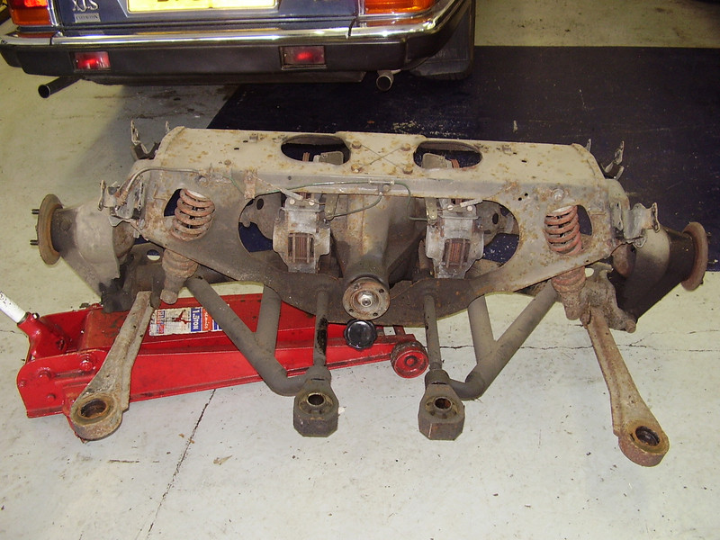

With all this power are planning to brace the diff?
Here is a pic of a Lister XJS rear end

yes im planning on setting up a system thats pretorqued to make sure I don't rip the diff out
That looks a lot like a setup Rob Beere offers for E-Types, and similar to what I've seen built by guys who race XJSs. However, in so doing, they eliminate the factory trailing arms. It's curious that Lister retained them.
All the cage mounts were ripped to shreds on my donor, so I bought a used XJS-C diff truss to make sure that same engine/tranny/diff ratio doesn't do the same thing to JagZilla. It's the same solution Bradley Smith used when he had that problem with his twin supercharged XJS.

my buddy Robert Knodt did a setup with triangular trailing arms
His setup is the very example I was thinking of. He's a heck of a fabricator.
