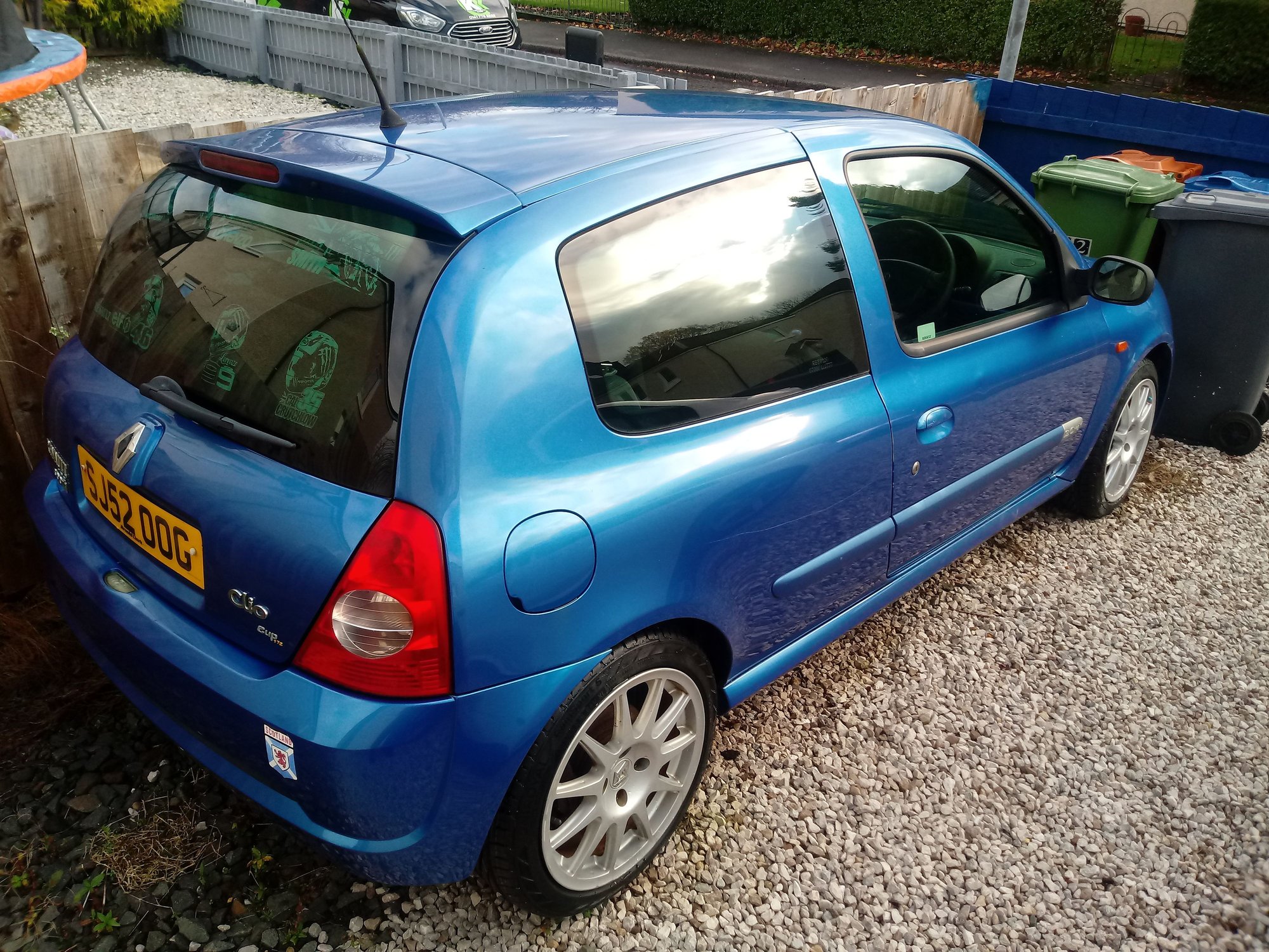

Hmmmnn, Listerine, good shout. I will have a look at the eternal air vent tomorrow, see if it is blocked.
My Clio Cup had a similar issue, blocking and overflowing into the cabin with water, once the pipes were cleared, air hose, its been fine...I do need a new carpet for it right enough.
I have had the wee car 19 years now...
2000 16v 172hp...serious fun.
Anyway, back to Jag stuff.
