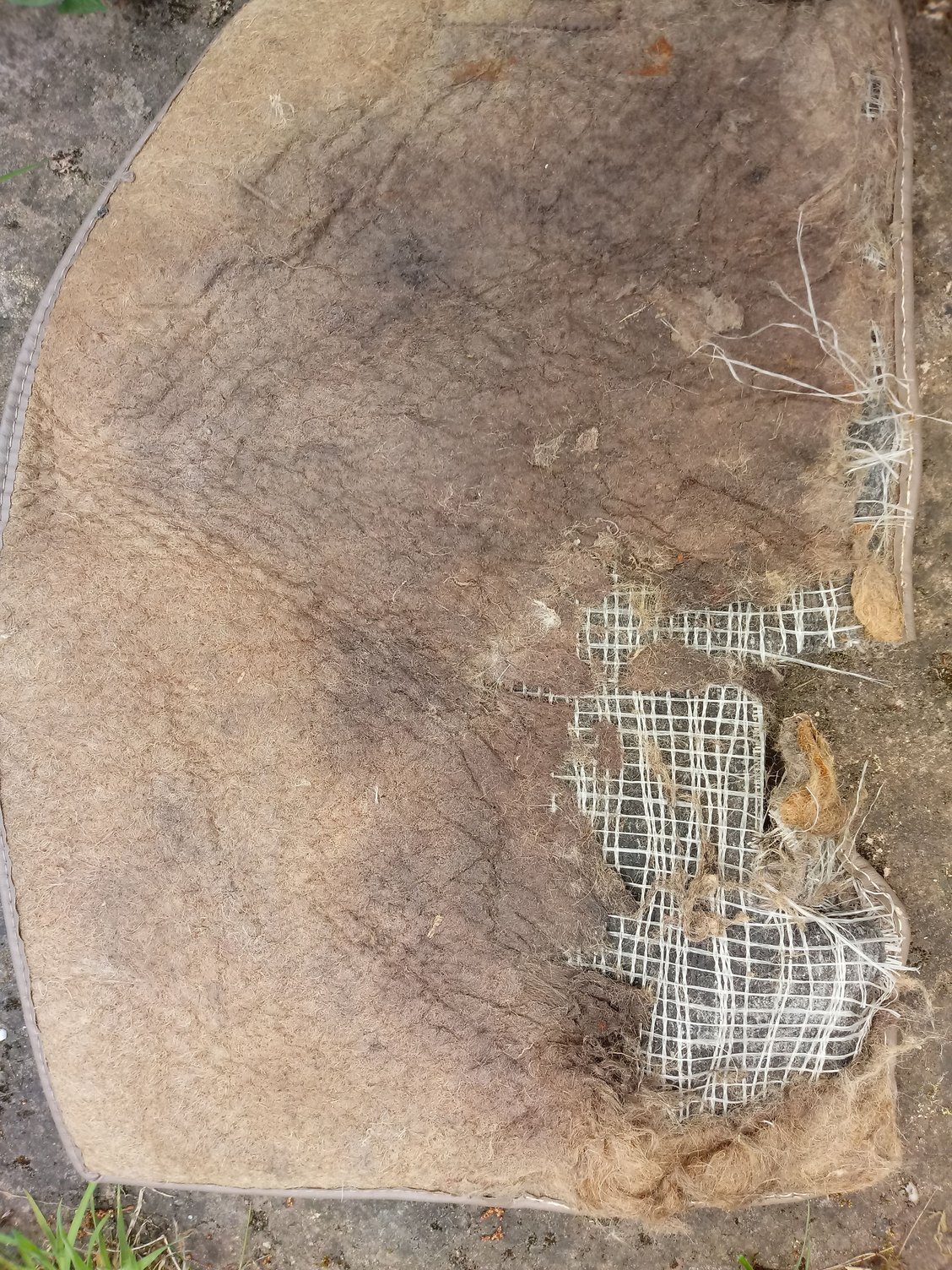

Just to update guys, I found the smells origin.
I did buy a deodoriser from Ebay, £60...it didn't work because.....
The passenger side carpet, underneath the seat was disintegrating and stinking and spreading the smell to the wool carpet in the car.
I am going to order up a new carpet from Aldridge's, Its already been priced up.
I did check the carpet, but I just lifted up the front part and it was dry and looked good. It was the rear section, underneath. The top part looks ok as you can see in the pics.
Thanks for all the advice.
Gee.
