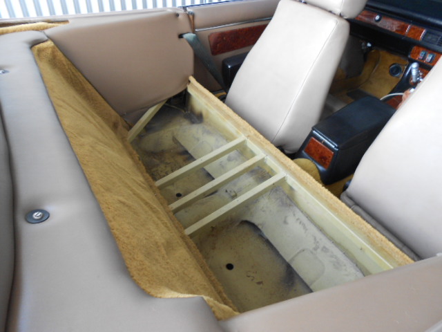

I am working in fabricating a removable seat delete. I already built the back section using my existibg back seat squab, here are some pictures. Once I get bottom section finished I will posts some more pics. As always started on one thing and the I am already here might as well do this also disease hit me.

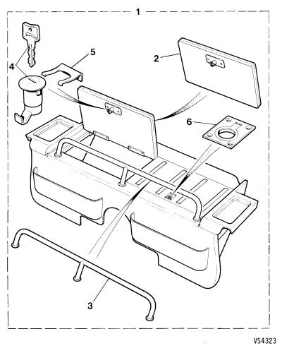

Attached Thumbnails Can I convert my 2+2 to a "proper two seater?-full-1988-jaguar-xj-sc_3804_20.jpg   Can I convert my 2+2 to a "proper two seater?-mv4323.jpg   Can I convert my 2+2 to a "proper two seater?-img_0537.jpg

Thanks Hep! Keep me posted on how you progress and how it turns out. Just out of curiosity - are you planning to manufacture and sell conversion kits, or is this "just" for you?

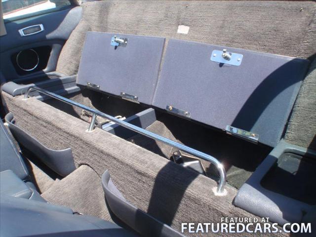

The box on the 89 only has one compartment, with a large single door to access it. The first time I ever saw twin compartments on a box was when I saw the photos on this thread. The box on my 89 also had factory speakers mounted in the front wall, with standard XJS speaker grills. The speakers were aimed in such a way that they would have been projecting sound toward the back side of the front seats. The Previous owner removed those speakers, and put small electric fans (like you would find in a desktop PC) in their place, behind the speaker grills. The fans draw fresh air into the box, to cool the on-board PC and stereo amp he had inside the box. I will likely do the same thing, but, because of the shape of the floor under the current rear seat area, I will also weld a suspended wire shelf into the area, to further help circulate cool air around the on-board PC and other electronics.
I believe the box shown in the photos is from the XJ-SC, I'm not sure but I think it was different because of the extra bracing put into the floor to make up for the partial loss of the roof.
I think Jagzilla is right, when Jag produced the 2+2, they welded and extra plate along the rear floor below the rear seat, this might make fitting a box a bit more difficult.

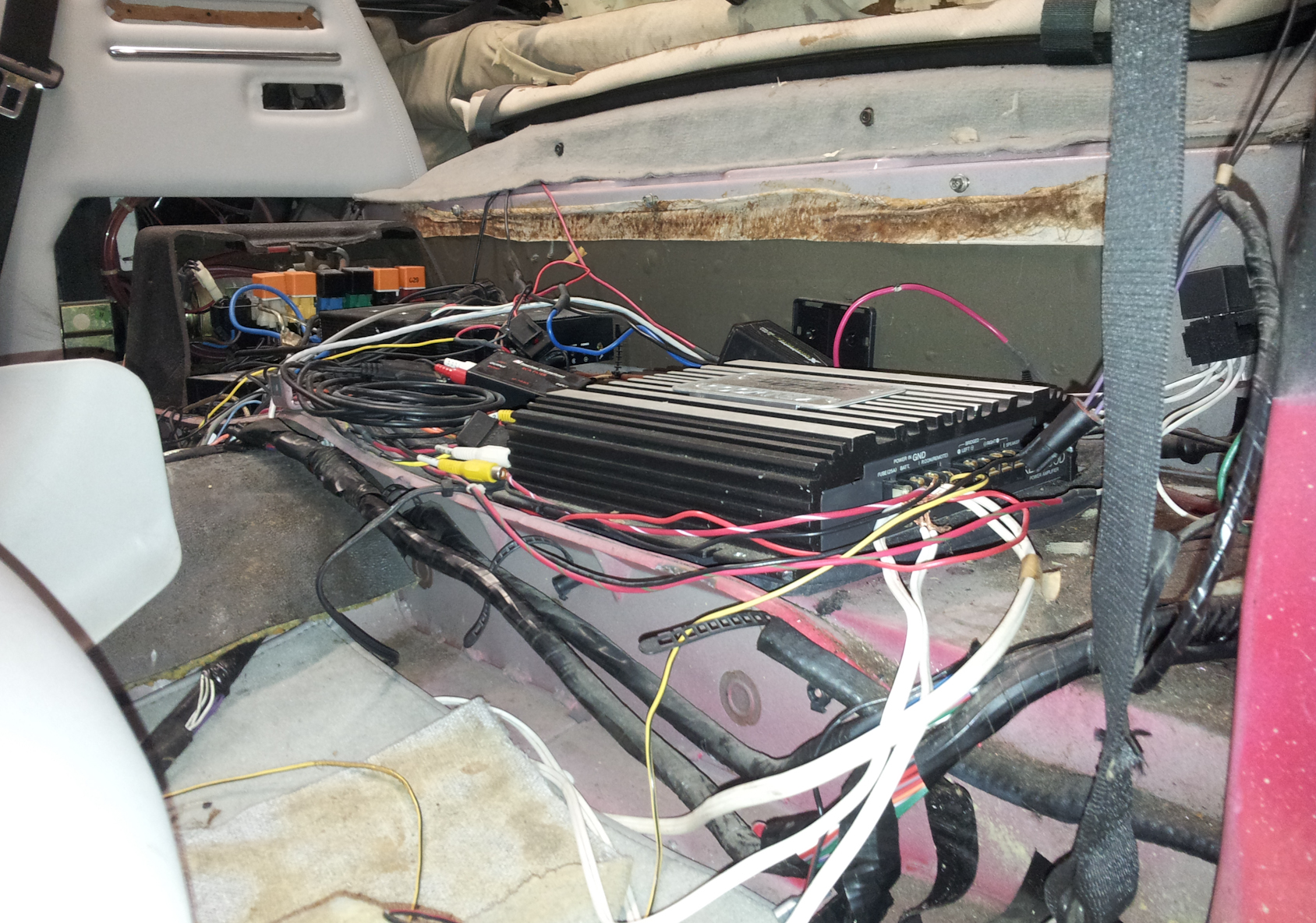

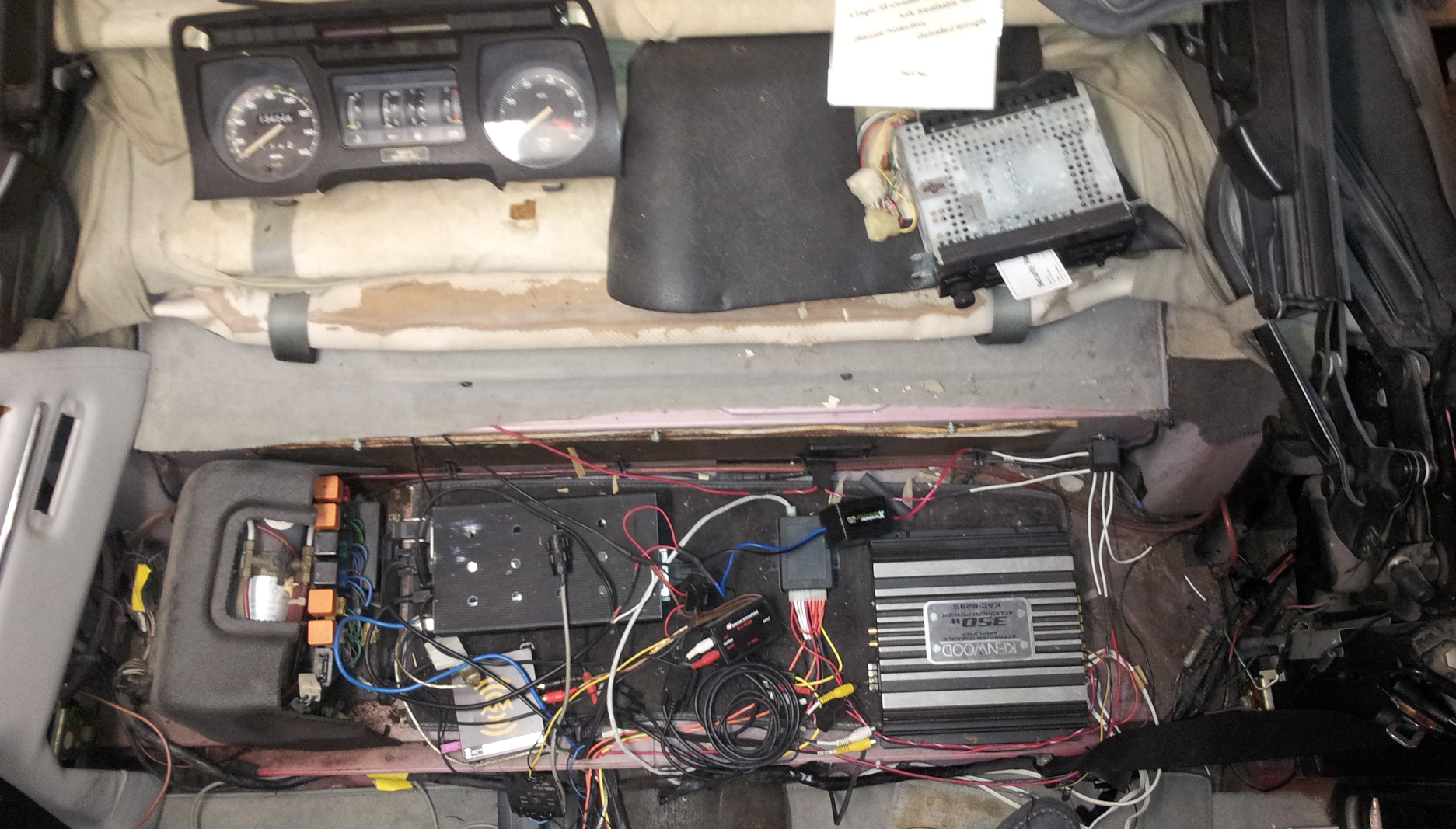

As promised, here are some photos of 89 2-seat convertible box, the area under & behind the box, some photos of the area under & behind the rear seat of Jagzilla, and some photos of the box placed inside JagZilla.
All the pix can be clicked to enlarge.
The first 3 are the area under the box in the 89 'vert:
Now the box itself:
Now inside JagZilla:
