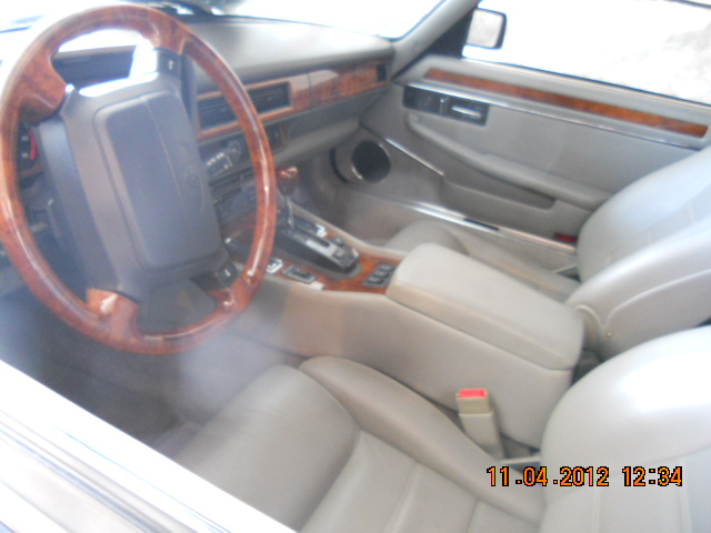

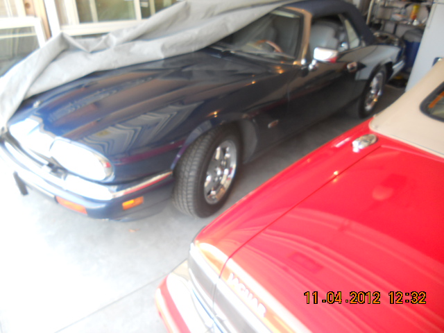

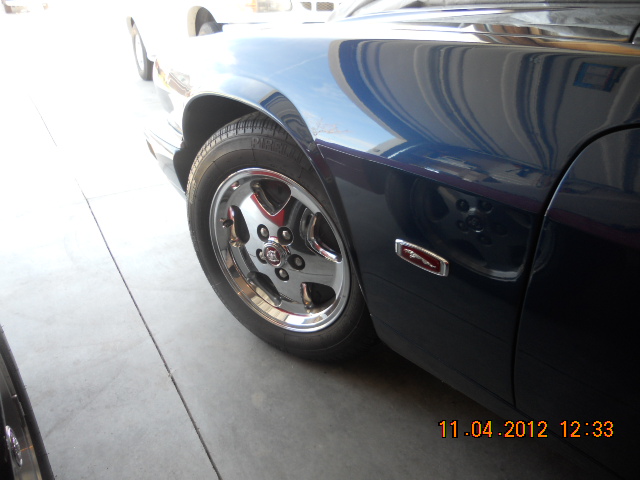

I have three '95 XJS' and from what I understand there is some confusion on what is a true '95 and what is considered a " celebration " model or '96 at least here in the United States. All celebration models at least here in America were equipped with OBD2 and have the seat piping and the leaping jaguar is embroidered in the headrests of the seats. All the celebration examples came from the factory with the half wood steering wheel and aero wheels as stock but the wheel could have been switched out at the dealer or special ordered with the chrome five spoke from the factory.
The tricky thing is you could find a non celebration example with some or all of these items added or switched to the car except the OBD2. It is unlikely you will find a '95 with the AJ16 with the seats put in from a '96 but not impossible.
The reason I have stayed with the '95 AJ16 version is because I have read and seen first hand the '96 celebration with the OBD2 having an issue with a high idle and it appears this can only be re calibrated on the '96 with a Jaguar scanner. This issue does not appear that uncommon with the '96 so just not worth it to me to deal with. I also really like the 5 spoke factory wheel on the '95 and find the '96 aero wheel to my eye makes the car look older. This is not a deal breaker as the wheels can be switched out and often are on a true celebration example.
As far as the half wood steering wheel goes I do like the look of them but many are cracking or sun damaged now. Keep in mind that a factory half wood steering wheel can be put in a '95 with no issues and one of my '95's had a all wood steering wheel installed and it looks wonderful.
