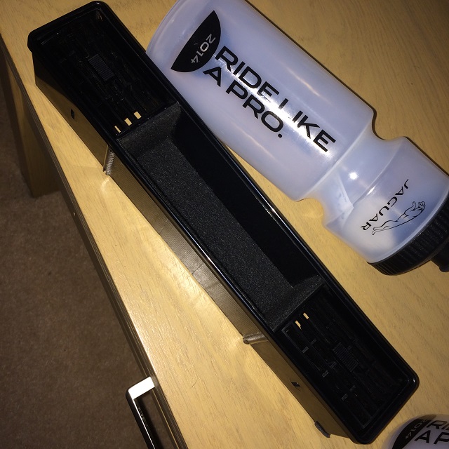

with this in mind I purchased a good used centre vent for the XJS , and proceeded to chop it up :shock:
but I did have a plan , I bent some sheet tin , and formed a ' pocket ' and then covered it in period looking flock that has an adhesive backing , and ended up with this
824 by MyPix on Talk Photography
not bad if I say so myself

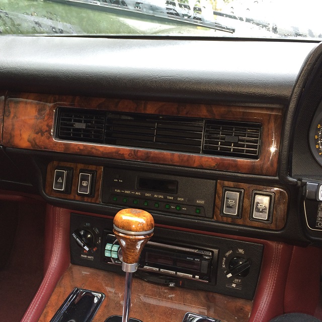

I then went to my car and removed my perfectly sound original vent, this is easily done by dropping the glove box door and gently prying off the walnut trim with a suitable tool , and
then removed the vent which is just a push fit

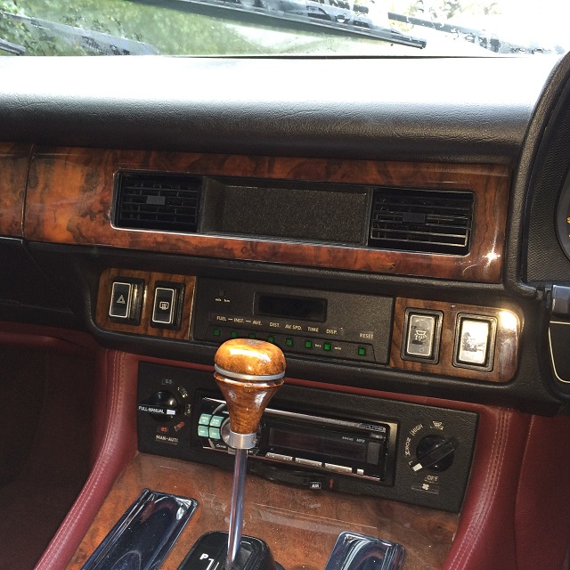

and then installed my modified vent grille , and put the walnut trim back in place
833 by MyPix on Talk Photography
I still have my original vent should I wish to go back , but now have somewhere other than the ski slope to put change or keys etc , slightly too small for my iPhone though :roll:
and as for the extra air ?? , well , its a little better , lmfao :mrgreen:

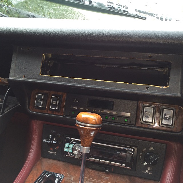

Here is my temporary, down-and-dirty center vent blocker;
Later, when I have time, I will make a black plate with a Leaper and mount it flush with the side vents.
